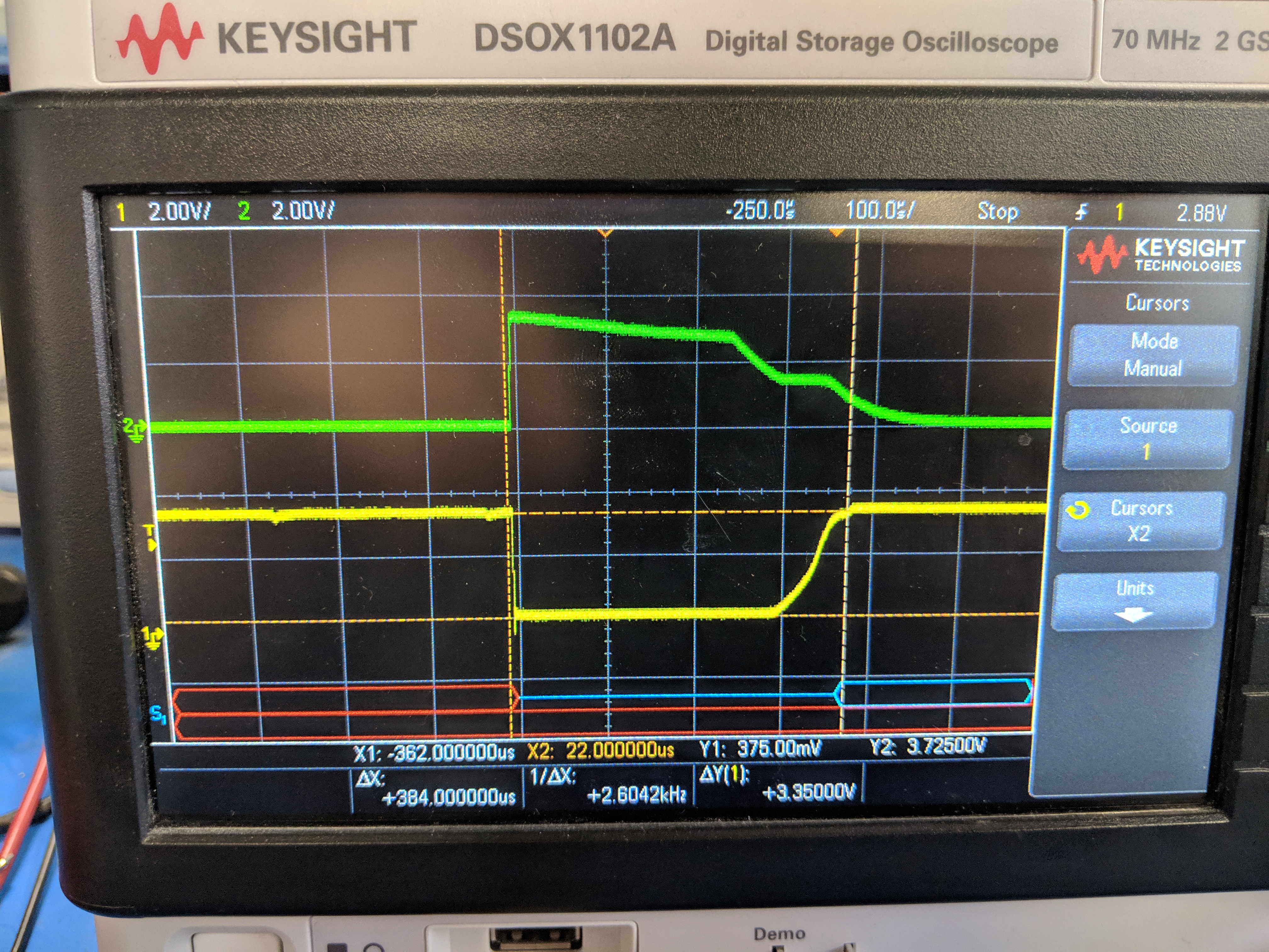

I am working to integrate part BQ25890 as part of a student project. The device manages a single 18650 and powers a device requiring 5A continuous current. I have followed TI's reference design and layout guidelines and upon testing the board under load have experienced some problems. After drawing 4.5A for about 10 seconds the device shuts off, I believe due to thermal shutdown but I am not positive as I only had a handful of times to test. After testing this behavior a few times the device now shuts off instantly when any significant power is drawn (>500mA). The resistance between BAT and SYS is now 75 ohms. There are no faults reported and I can still communicate via I2C.
I've followed TI's reference design from the datasheet and have included PDFs of my layout and schematic.  Please let me know if you see any issues or if I just need to heatsink the chip more carefully.  I am certain that the rest of the board can handle the current, as I have tested the device under load simply supplying voltage to the SYS pins and there are no thermal issues.  From my calculations my 5A load should produce about 0.5W of heat, according to an Rgs(BATFET) of 19mOhm.
The physical board is 1oz copper with 2 layers.  I am certain there are no shorts or mechanical issues with the board and was careful during the reflow process to rework anything wrong with the board before powering it.  It works perfectly fine just powering the microcontroller and OLED, only when I apply load does the SYS voltage drop.  I have also attached pictures of the behavior on my scope - the green channel is voltage to the gate of the MOSFET controlling the load and the yellow channel is SYS voltage.  You can see that the device very quickly responds to the load and SYS voltage recovers when the MOSFET shuts off.

  • Hi Robert,
    Regarding your thermal calculations, you are correct in that the losses are RDSon(batfet)*ISYSload in battery only mode. When powered at VBUS, from Po/Pi=efficiency and Pi-Ploss=Pout you can compute Ploss. Using Ploss and RthetaJA, you can estimate the losses. RthetaJA assumes a board with 2oz copper and large, unbroken ground plane for the thermal pad to via. On your layout, with 1oz and the broken up ground plane on the bottom, I suspect the device is hitting either thermal regulation, where it reduces output current to reduce IC temperature, or thermal shutdown. Do the I2C status register report thermal regulation?
    At room temperature and VBUS = 7 to 9V, the BQ25890EVM with 2oz copper and larger, unbroken ground plane can provide 5A output.
    Jeff

  • Hi Jeff,
    The samples came in and I was able to replace the IC to replicate my issue.  When I attach a dummy load of 1 ohm to SYS and only power the device through BAT after some time the device again ceases to work.  The REG10 bit 7 isn't flipped but the IC gets very hot.  After some time with the load attached (and drawing 4-5A) BATFET is disabled (REG09 bit 5).  After this behavior starts BATFET is instantly turned off when the load is attached.
    What's strange is that the MOSFET also dissipates a similar amount of heat and hardly heats up at all - in fact, I've left the MOSFET on with the load attached for up to an hour and it hardly gets hot.  Please let me know if you have anything else that I can troubleshoot in case my issue is somehow unrelated to thermal performance.  I may simply need to move to a second revision where I revise the layout to improve thermal performance.  However, I would like to confirm that this is in fact the underlying issue first.

  • Robert,
    The thermal shutdown shutdown circuitry only impacts the buck converter. I now agree that the heat generated from the losses across the BATFET is not being dissipated by the powerpad through the board. My only suggestion, without relaying out the board, is to use airflow across the top and especially the bottom of the board.
