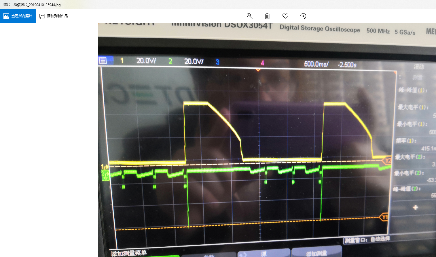

My customer's TPS23751 damaged after power on and they found the GATE pin shorted with GND.
Attached are schematics and VDD(yellow),VSS(green) waveform.
Please help to review their design and input your comments.

Hi Darwin,
As customer feedback, they used 42.3ohm instead 430ohm on schematics.
What else point would you suggest to check?
