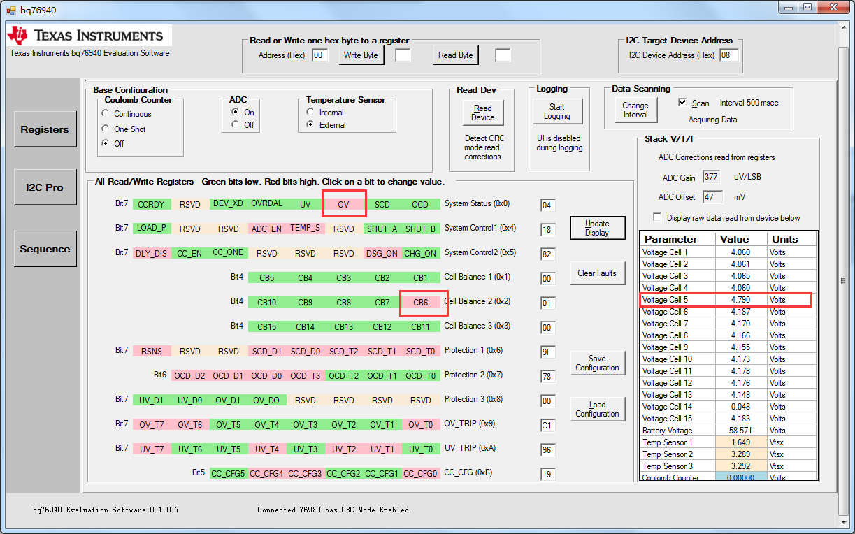

   In the case of charging, I turned on the equalization function of CB6, but the OV protection was instantaneous. The threshold of my OV setting is 4.3V. It can be seen from the PC software that the voltage of the 5th string has reached 4.7v, but I checked with a multimeter and found only 4.2v. How can I solve this problem?

    It would seem there is a connection problem on the board.
    If it is an EVM used without cells be sure the cell simulator switches are closed, note that the cell balance will alter the voltage across the resistor divider and other cell voltages will change.
    If it is an EVM used with cells be sure the cell simulator is off so the cells do not drain. Check the connection to cell 5 since it seems turning on cell 6 balancing caused the cell 5 terminal to go up and the voltage to report high.
    If it is your own board check connections of VC5, VC5X and VC5B to the cell through the appropriate filter resistors and topology shown in the data sheet or other reference documents.

    If you have designed your own board for a battery it is unlikely you included simulation resistors. On the EVM they are the resistors shown in Figure 40 of http://www.ti.com/lit/slvu925. The switches are S3 and S4.
