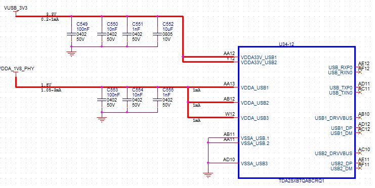

The SOC function modules related to power supply from VDDA_1V8_PHY are not used.

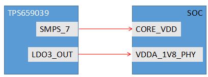

We are testing the TPS659039 power-up sequence and found that the power-on sequence of LDO3_OUT is abnormal.(Note that there is a voltage step before power-on.)
The SMPS_7 of the PMIC output is used for the CORE_VDD supply of the SOC, as shown by the green line;(This voltage step seems to be related to the power supply of CORE_VDD)
Another LDO3_OUT is used to power the VDDA_1V8_PHY of Soc, as shown by the yellow line;
Can you give some advice and how to solve it?
