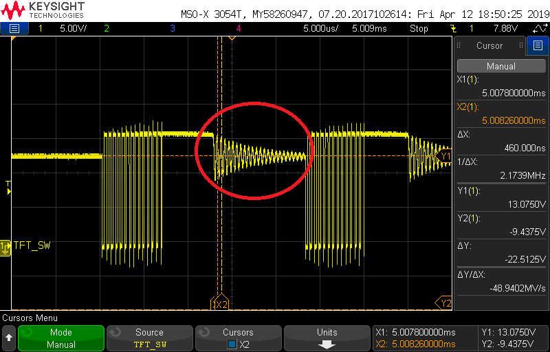

We are using TPS61193 part in one of design for Gauge illumination back light section.
FSET = 28.7K , which is 1.9MHz, while measuring at SW pin observing some ringing between the clock cycle (highlighted with Cursor) at operating VIN = 10V to  13.5V
At VIN is 6V-9V & 14V to 18V, not observing any ringing , waveform looks stable between the clock cycle
Note: Clock cycle are not continuous. Please see below waveforms and schematic page.
Why is this kind of behavior observing with different voltage. Please help us.
After adding the Snubber Circuit - Ringing section changing.
Schematic is attached:
