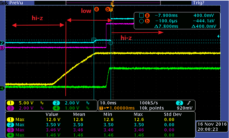

  • hi Damian,
    I am looking into these questions and will give you feedback on Monday.
  • Hi Damian,
    1. For soft start time, according to the system engineer who define the SS time equation, the SS time should be measured from 10% to 90% Vout rise time.
    2. Css charging current tolerance.   Please refer to datasheet EC table
        PG delay accuracy. 1.7 times soft start time. Please refer to below figure for demo
    3. The PG waveform is wrong in datasheet. Thanks for pointing out. The validation team connect PG pull up resistor to Vout. We are discussing on how to correct the datasheet for the TPS56x21xA family. Thanks!
