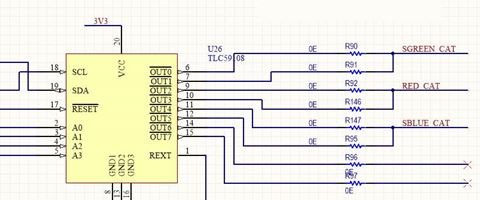

Can you send me the default commands to enable 50% power of the LEDs with the TLC59108?
Please send I2C commends as below:
1. Mode1: Address 00h, Data 01h;
2. Mode2: Address 01h, Data 00h;
3. PWM0-PWM7: Address 02h-09h, Data 80h;
4. LEDOUT0-LED0UT1: Address 0Ch-0Dh, Data aah
