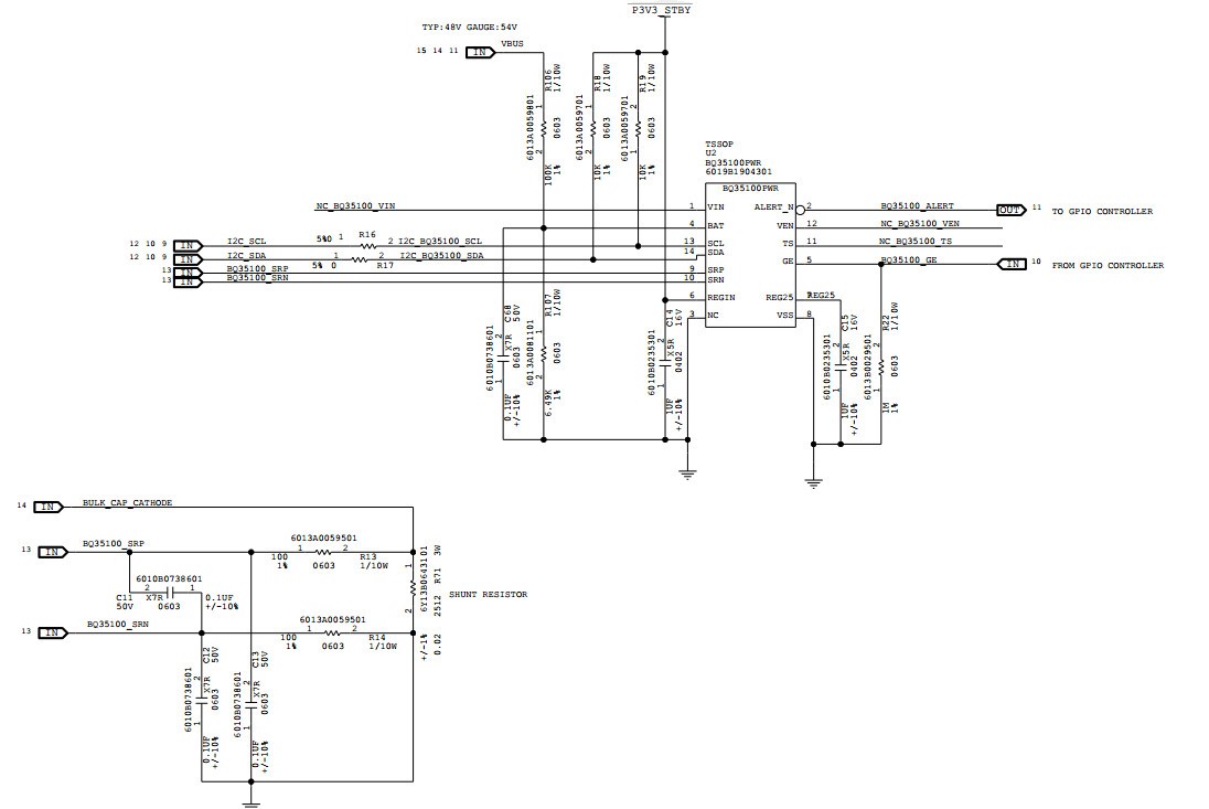

Hi Team,
Is it OK to use BQ35100 ACC mode for bulk capacitor capacity decline detect?
If it is OK, ACC would accumulate the capacitor capacity value, right?
Can it sweep previous value as every read command?
Also, any calibration tool of BQ35100 need for factory test?
