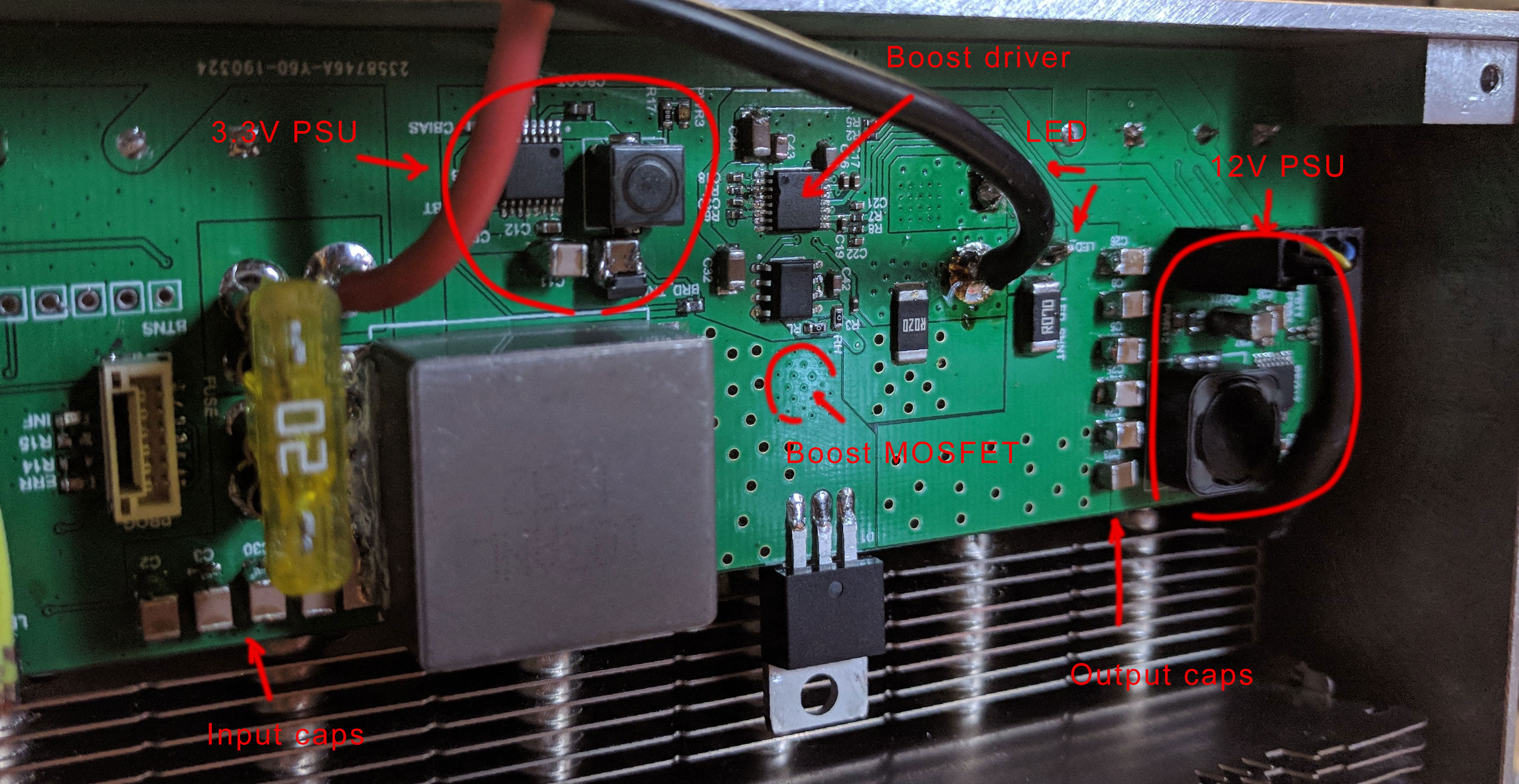

I designed a boost LED driver based on TPS92691. It drives 56V 5A COB LED from 22-50V input. It works ok.

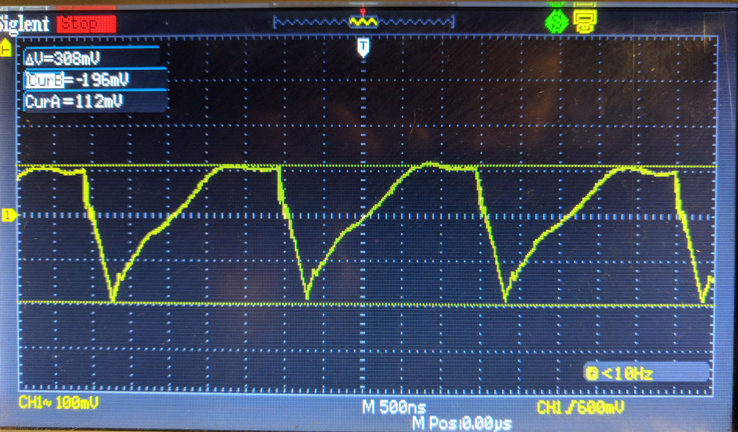

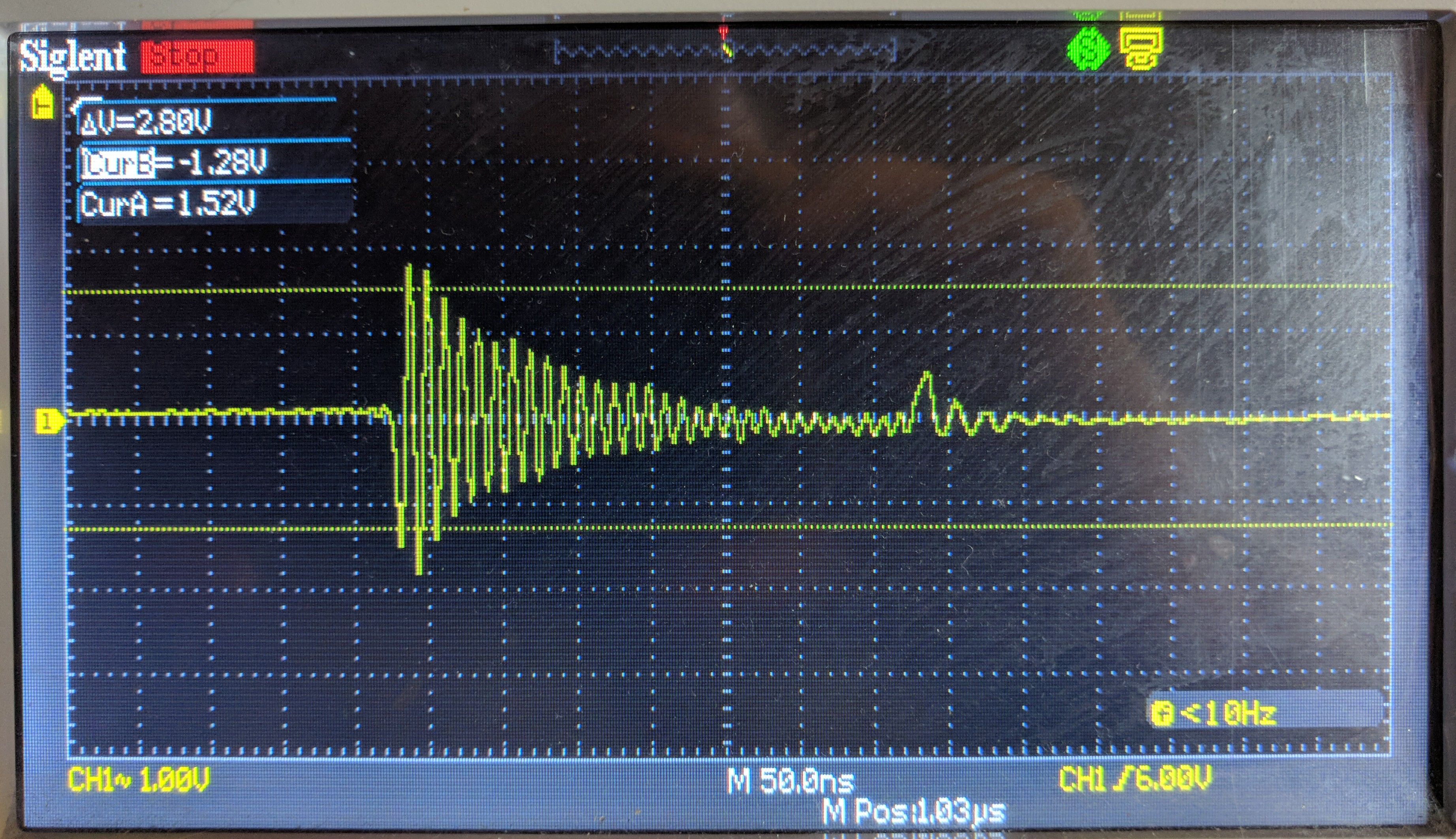

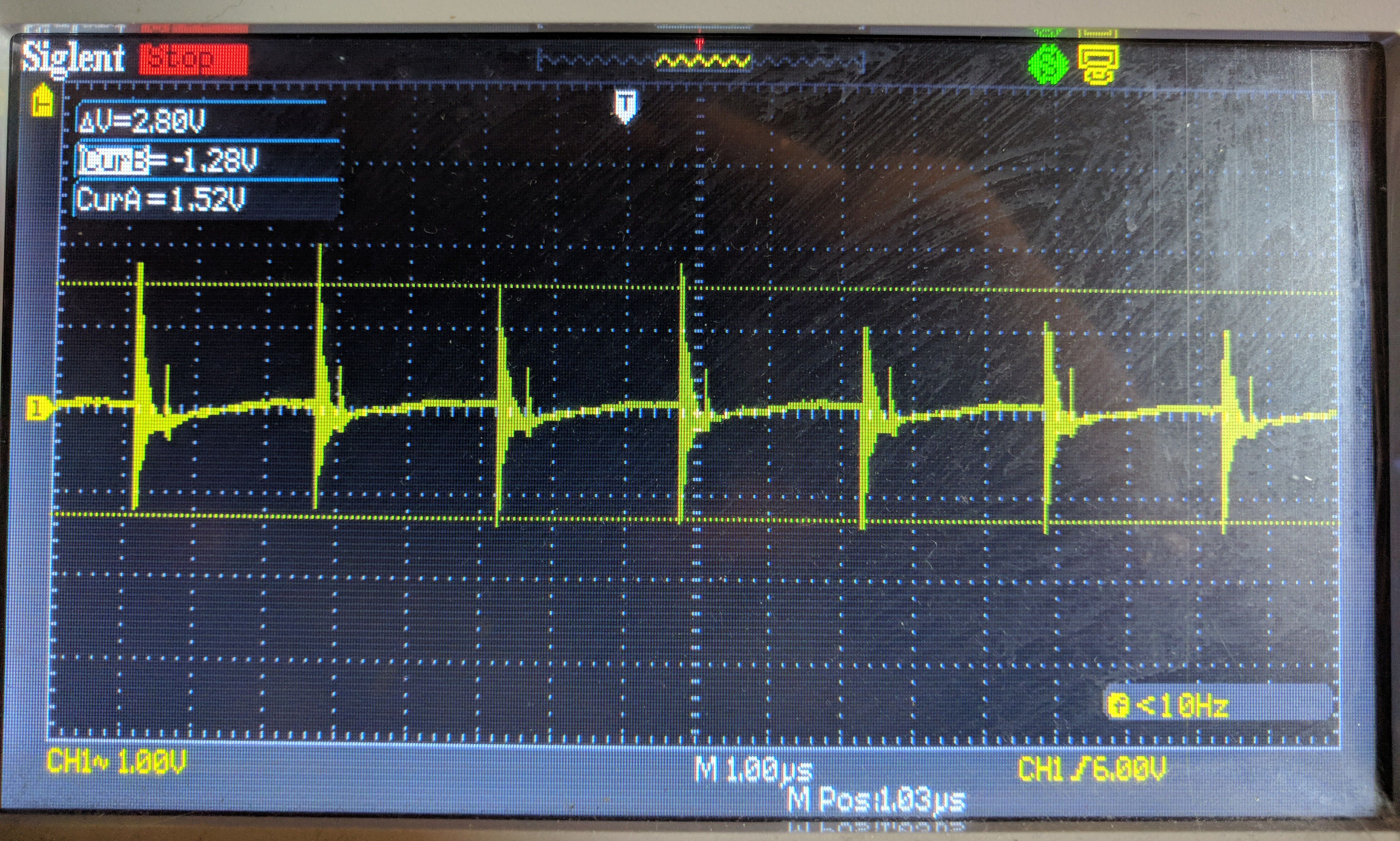

Oscilloscope shows small spikes on input (100mV), but large spikes on output (3V). The spikes are from switching (400 kHz).
I started with 4.7uF X7R output capacitor. Then added one more, spikes were reduced. Then added one more, which reduced spikes little more, but adding more capacitance does not change anything anymore.
I mesure with probe with wire coiled around it.
When the MOSFET conducts, the first bigger spike (ringing) occurs, then the MOSFET opens and the second spike occurs. Why this may happen?
Can the spikes be reduced somehow? Also, is it bad, will it harm anything?
