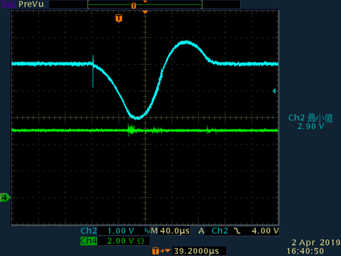

Our system has an USB port, that VBUS power from LM3150.
When connected the USB, occur the surge on VBUS and Vfb, LM3150 stop switching. Stop time is about 50usec. When during stop the operation, LG=High, HG=Low.
Therefor, Vout will be descend to about 3V, resume operation.
Question,
When Vfb=0.36V at Vout=3V. The voltage is lower than Vfb-ov.
Why doesn't device resume operation quickly?
