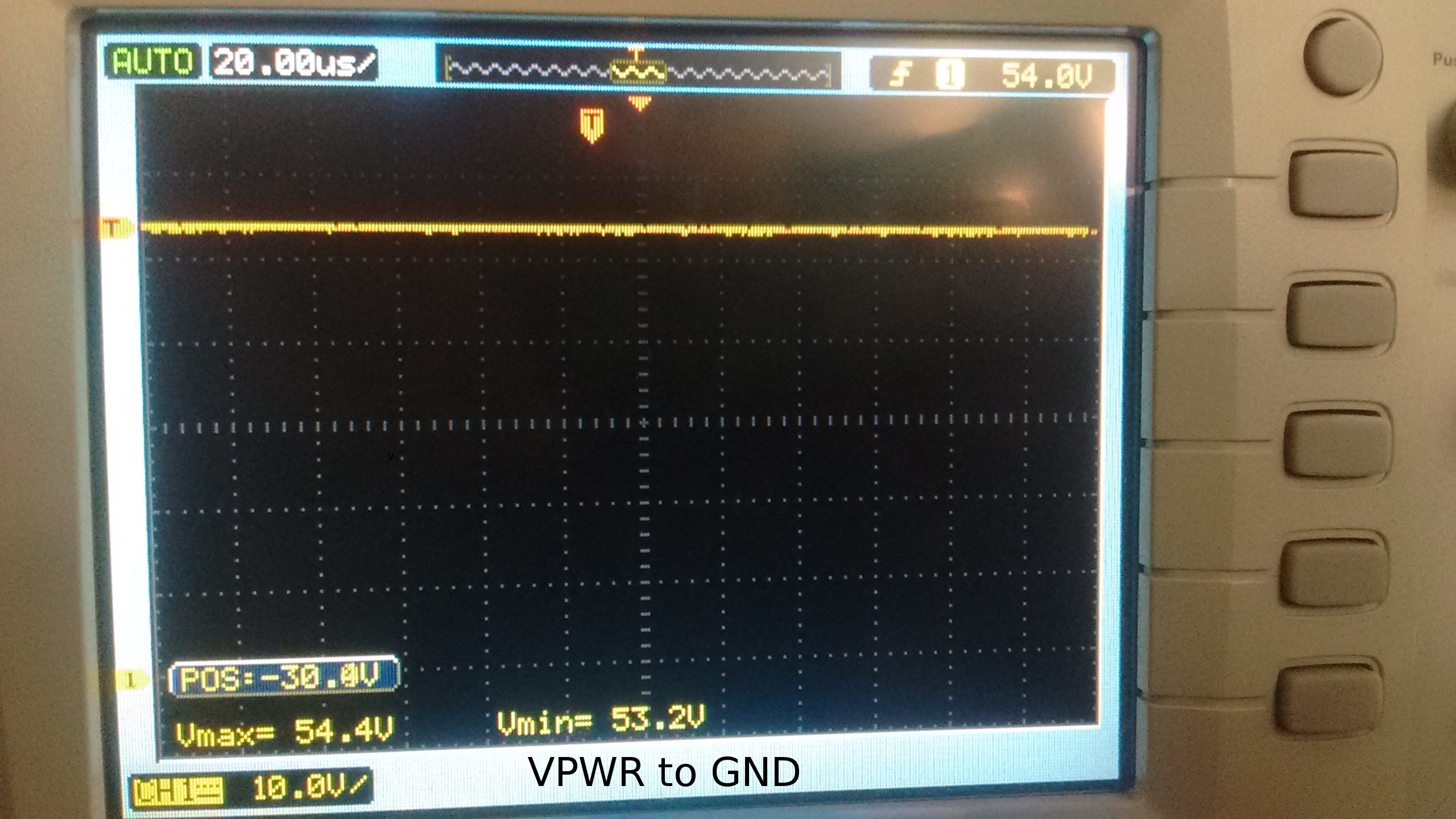

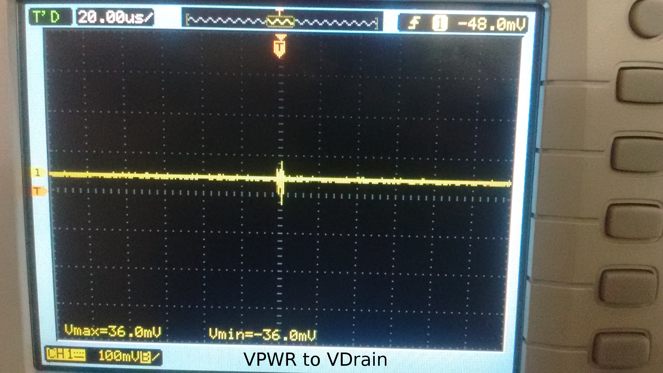

    I have attached the Register Readout values for all registers as well as the waveforms for Port Voltage(Vpwr to VDrain) and the input Vpwr signal(Vpwr to Gnd).
    Note that the after Power On- Reset values for registers 0x00, 0xA0 and 0x2C to 0x3F changed to 0x00.
    VPwr to Vgnd
    VPwr to VDrain:
    The conditions while capturing the readings are as follows:
    Vpwr Voltage: 54V
    VDD: 3.0 to 3.6
    Load: No Load.
    Please let me know if you need any other data.
    Thank you.
    Mikha.

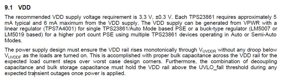

  • Hi Mikha,
    The VDD waveform concerns me as it dropped below VUVDDF after rising to VUVDDR. TPS23861 requires the VDD rail to rise monotonically through VUVDDR without any droop below VUVDDF as the loads are turned on. I will suggest you fix the VDD power supply issue and replace with a new TPS23861 device. Thanks.
    Penny
