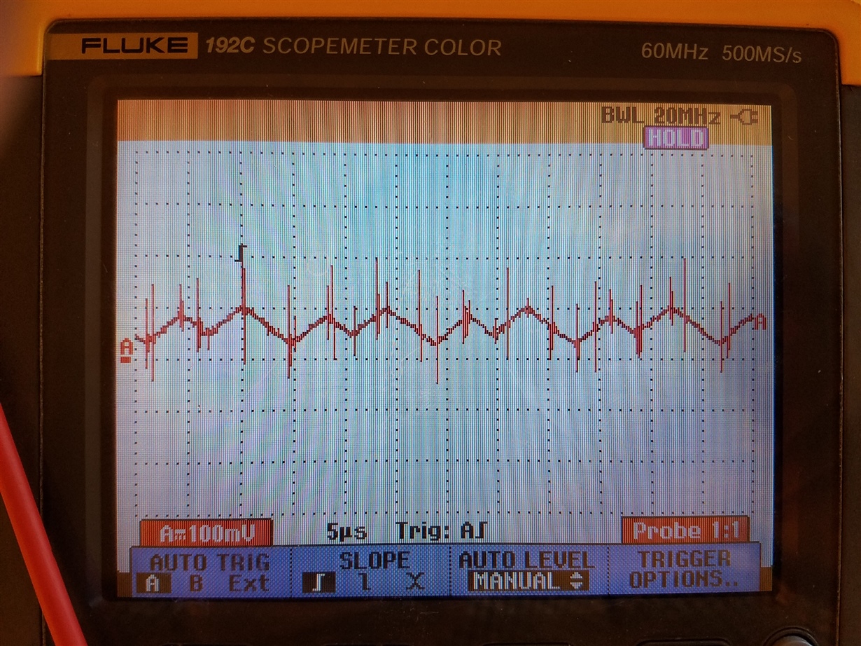

I also have the phase issue. Why does the application note SNVA796–October 2017 also have non 180-degree phase shift when input voltage is 264V?
The current sensor signal of my PFC is: as it can be seen, currents are not equal.
The output voltage and input mains current are:

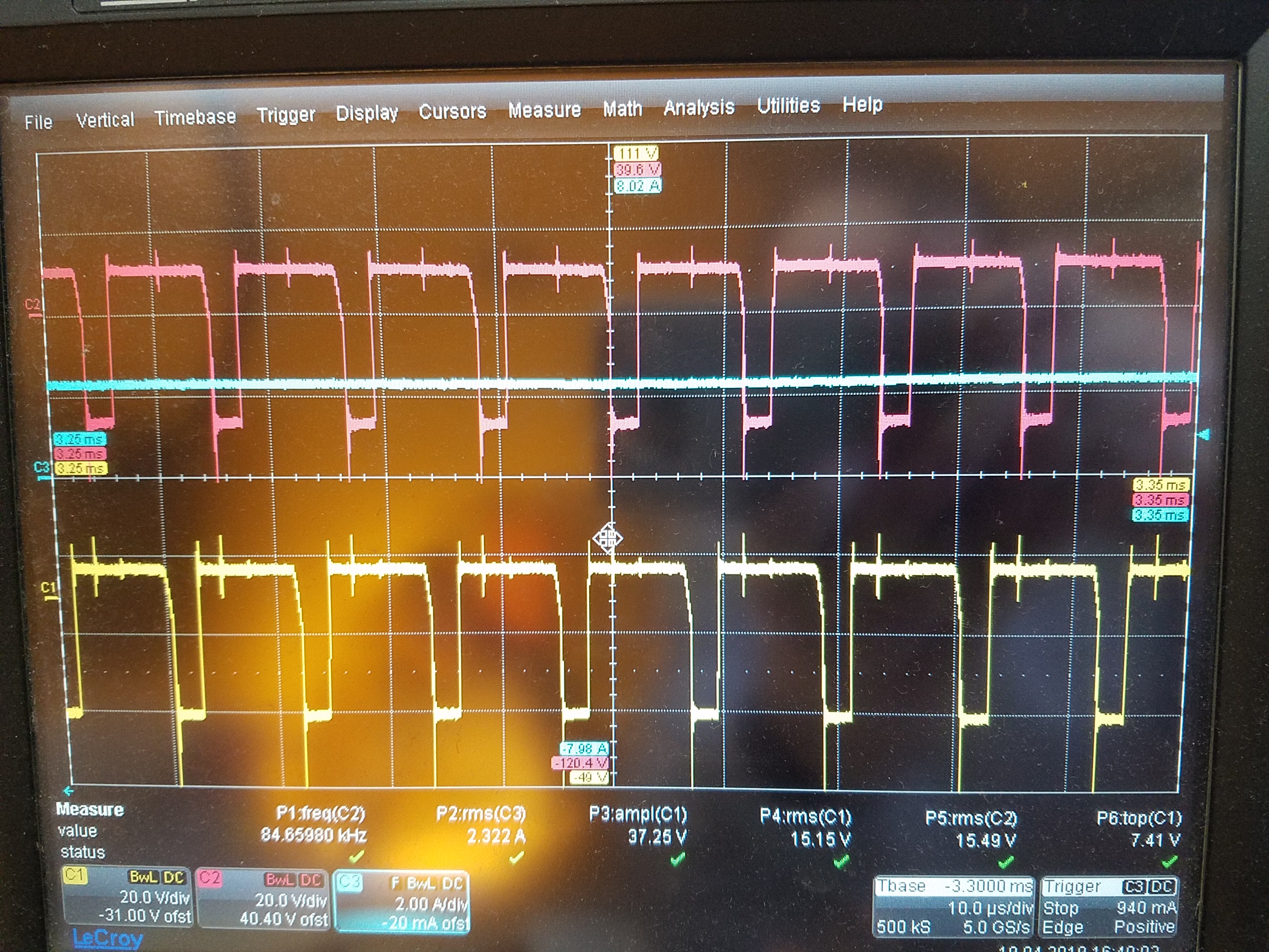

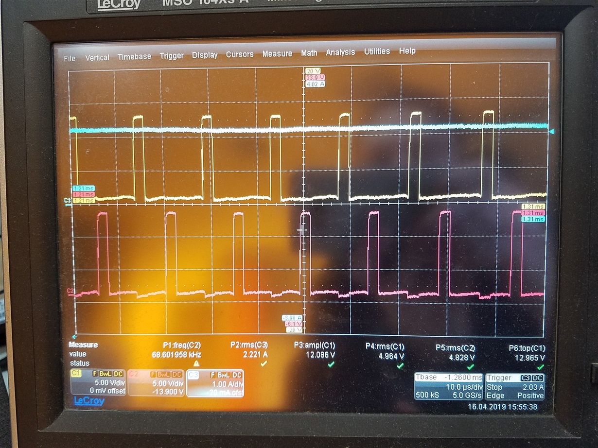

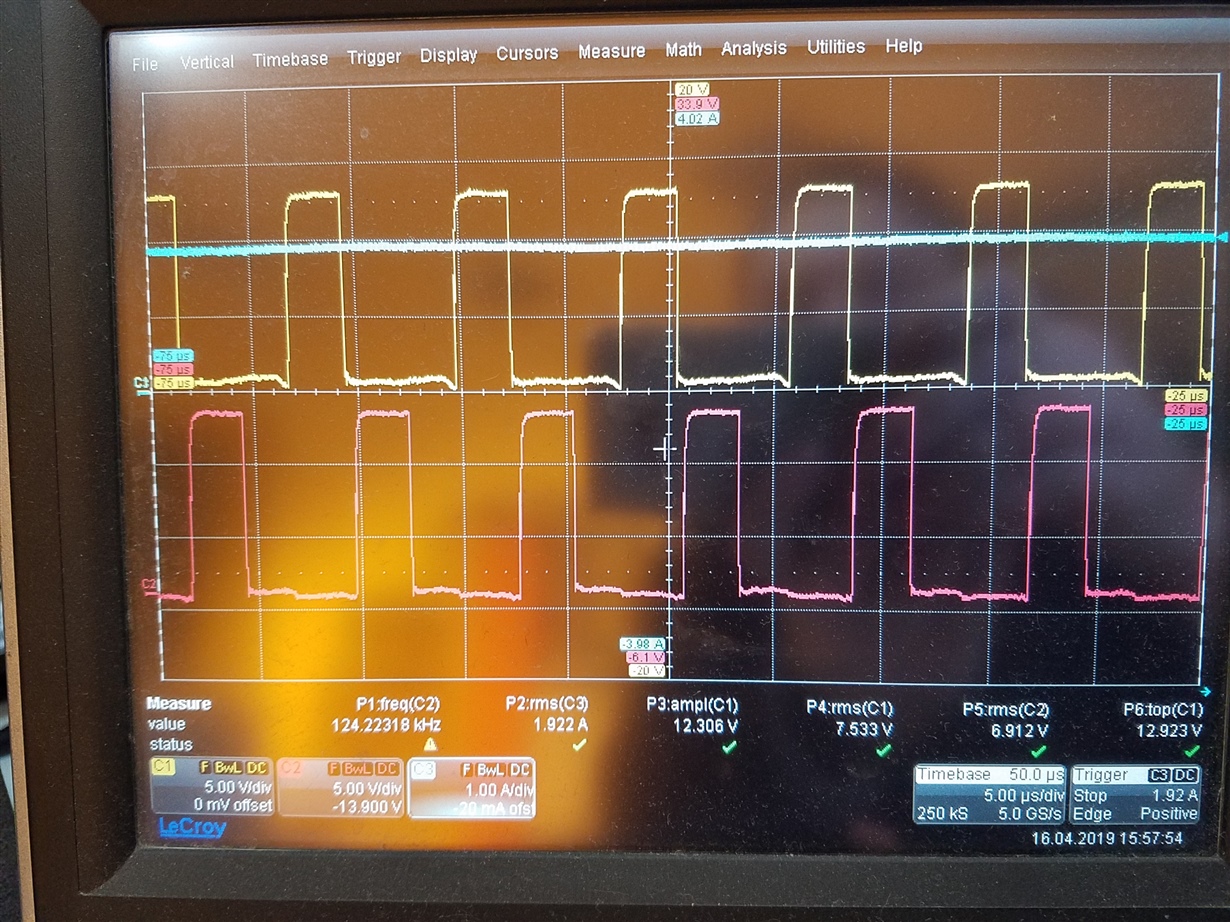

  • Hello, Mike. Here are the gate signals at the top of the input mains sine current:
    and at the bottom:
    as you can see the phase shift is not 180 degrees.
    Mike, you said:"The inductor ripple current cancelation changes with duty cycle which varies with line voltage. I believe that is all you are observing at the input. "  Mike, I didn't mean cancellation, I mean an equal peak current value in the inductors. If you have a 180 degrees phase shift and equal inductance value, the peak current value must be the same.

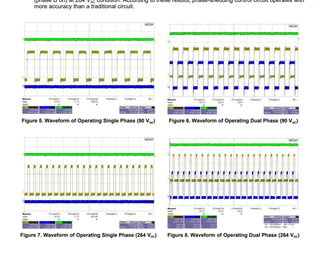

  • Hello, Mike. Can you show me any application note that describes a PFC that uses UCC28063 and has oscillograms of gate signals with a 180-degree shift?

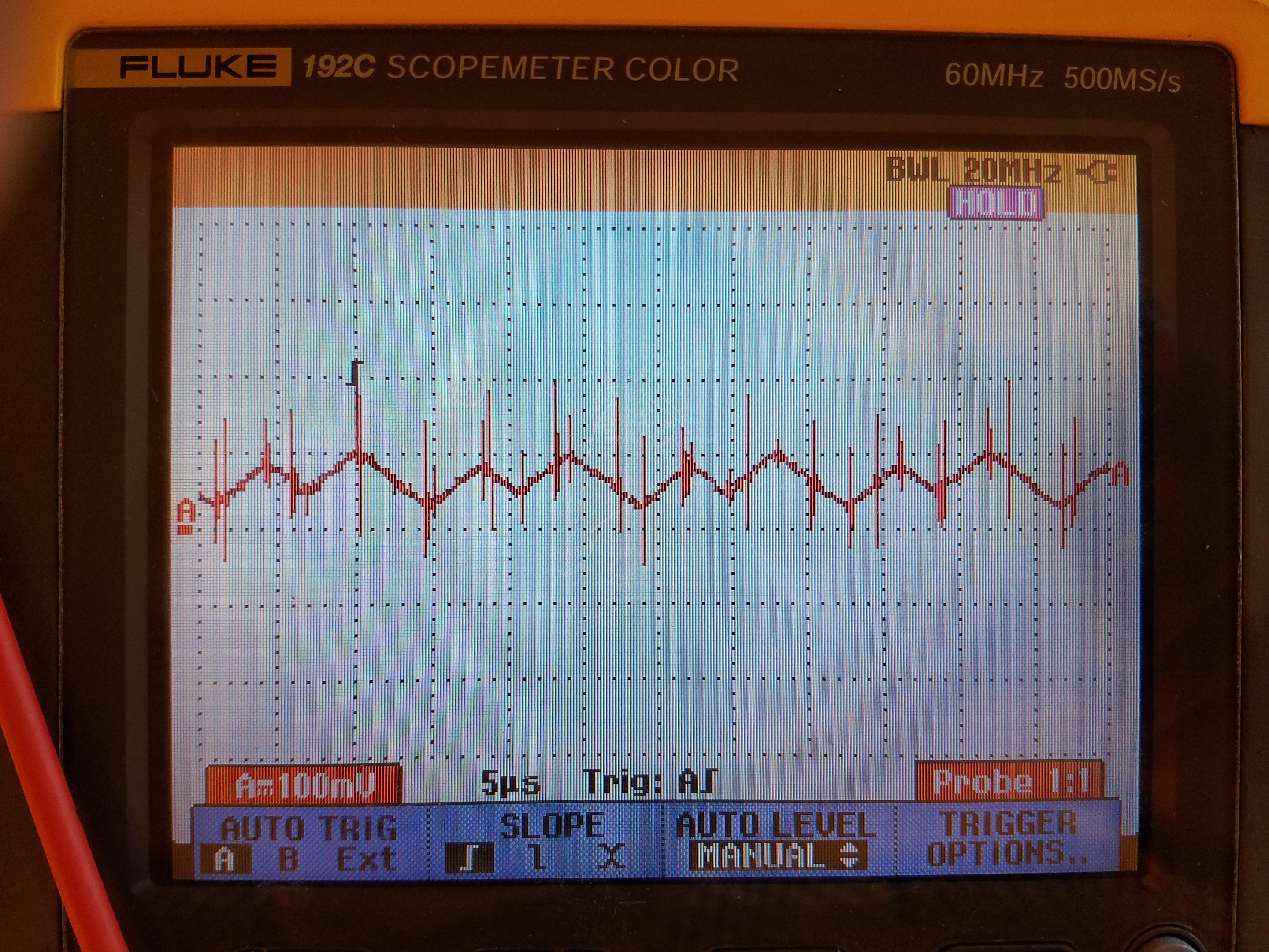

    My ZCD signals:
  • Hello Aleksandr,
    I found the user's guide for the User's guide for the UCC28063EVM-723 www.ti.com/.../sluu512.pdf. It does not have the gate drive waveforms but has inductor ripple current in figures 11 and 12. They are 180 degrees out of phase. This EVM is orderable for you to evaluate.
