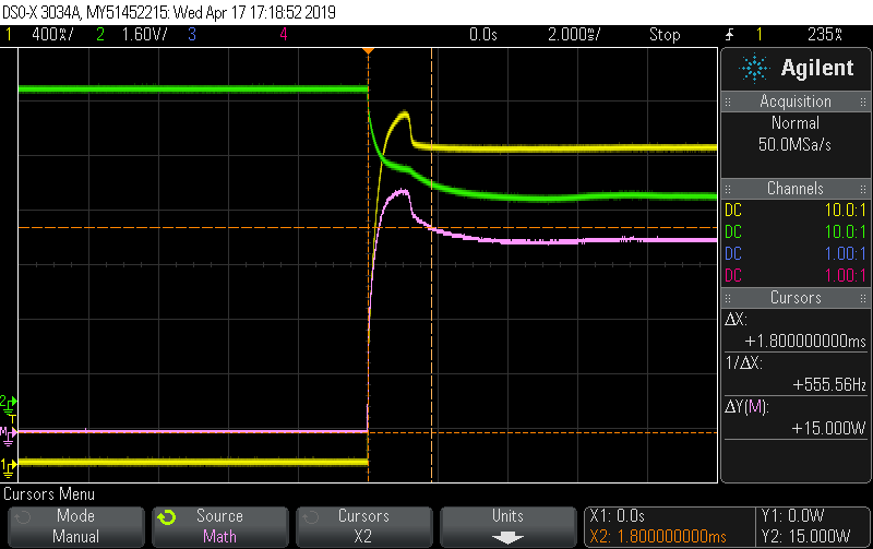

  • I also have an additional follow-up question:
    If the ILIM is set to 2 A and the current in the circuit reaches, let's say 2.4 A during transient event, how long time will it be before the current is limited? Do you have a typical graph for similiar scenario? Datasheet only seems to specify the trip time for fast-trip 160% ILIM.

    If you set ILIM to 2 A and a 2.4 A is drawn , the device clamps the current to 2 A as long as it does not hit thermal shutdown. How fast a transient current are you expecting ?
  • Thank you for your reply.
    I did a measurement and concluded that in a similiar scenario, when the current goes up above the limit, the circuit limits the current  after around 1 ms. Yellow graph in the picture below shows the current, 400 mA / square.
