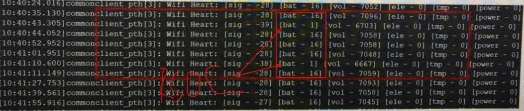

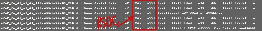

Dear Ti Experts,
My customer is evaluating BQ28z610, when they use EV2300 to read RSOC, it's ok; however, if they use host mcu through I2C to read 0x2c/0x2D every 10~30S, there will be some abnormal data occasionally , and back to normal next time, as you can see from below picture. Is there EV2300 get any filtering mechanism to RSOC? Or maybe there is any inappropriate command from host mcu I2C ? Could you kindly give some advice for this case? Thanks a lot. Customer only find the RSOC data have such issue and all other data from I2C seem all right.
