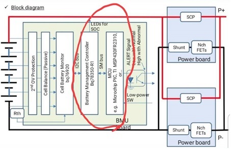

HI Sir
Below is our system block diagram will use BQ78350 + MSP430
Does TI have MSP430 reference code ? and used with BQ78350
    We do not have any MSP430 reference code for the BQ78350, but you might be able to find examples in other forum threads. The code really depends on your specific system. The BQ78350 handles all of the communication and fault handling for the BQ76920, so the MSP430 would only need to read information as needed or to issue commands if necessary.
    Here is a thread I came across: e2e.ti.com/.../2166982
