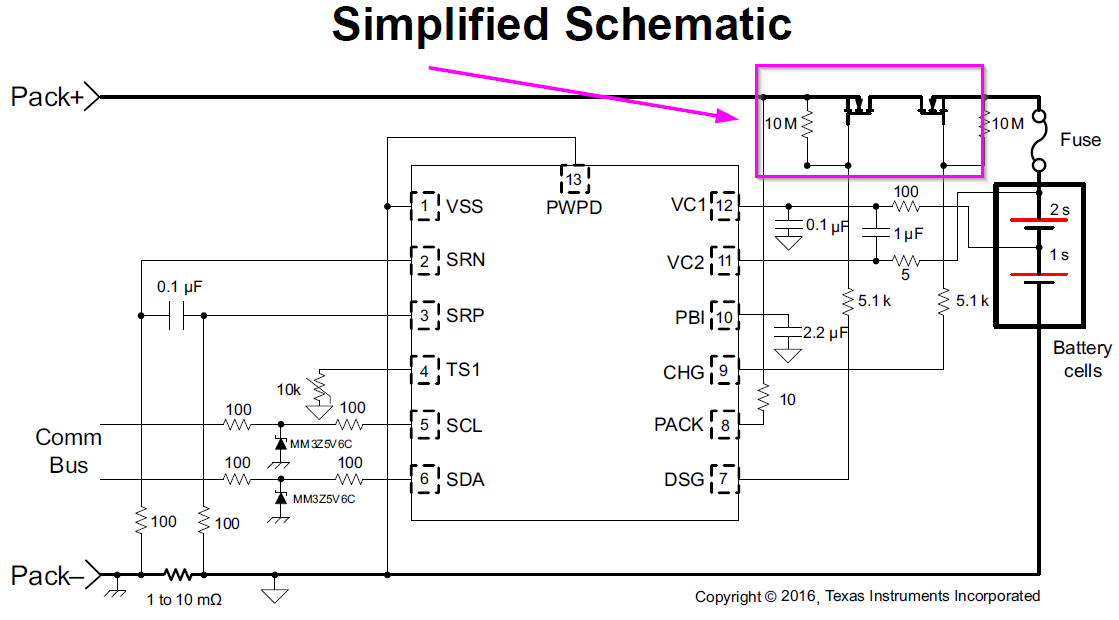

Team,
Are there ways to read the BQ28Z610 registers to identify which "system level protection" have kicked in?
For example can BQstudio + EV2300 / EV2400 be used for that? Or do you need an external MCU board to run customer SW to access I2C?
Can the EV2300/EV2400 connect to a custom board or only to the EVM?
Are the some guidelines on how to debug problems during developments?
The actual problem manifest itself with the BQ28Z610 that open/close the FET at a 25ms rate that make the pack voltage level oscillating between 3.8 and 4.2V:
Thanks in advance,
