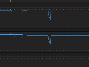

  • After some further testing, I have discovered that sometimes when a newly programmed bq40z50 is plugged onto the SMBus lines. It appears that the bq40z50 is "loading" the bus lines for an extended period of time.
    Please see screenshots below:
    Have you ever seen behavior like this from a chipset?
  • Is this using EV2400?
