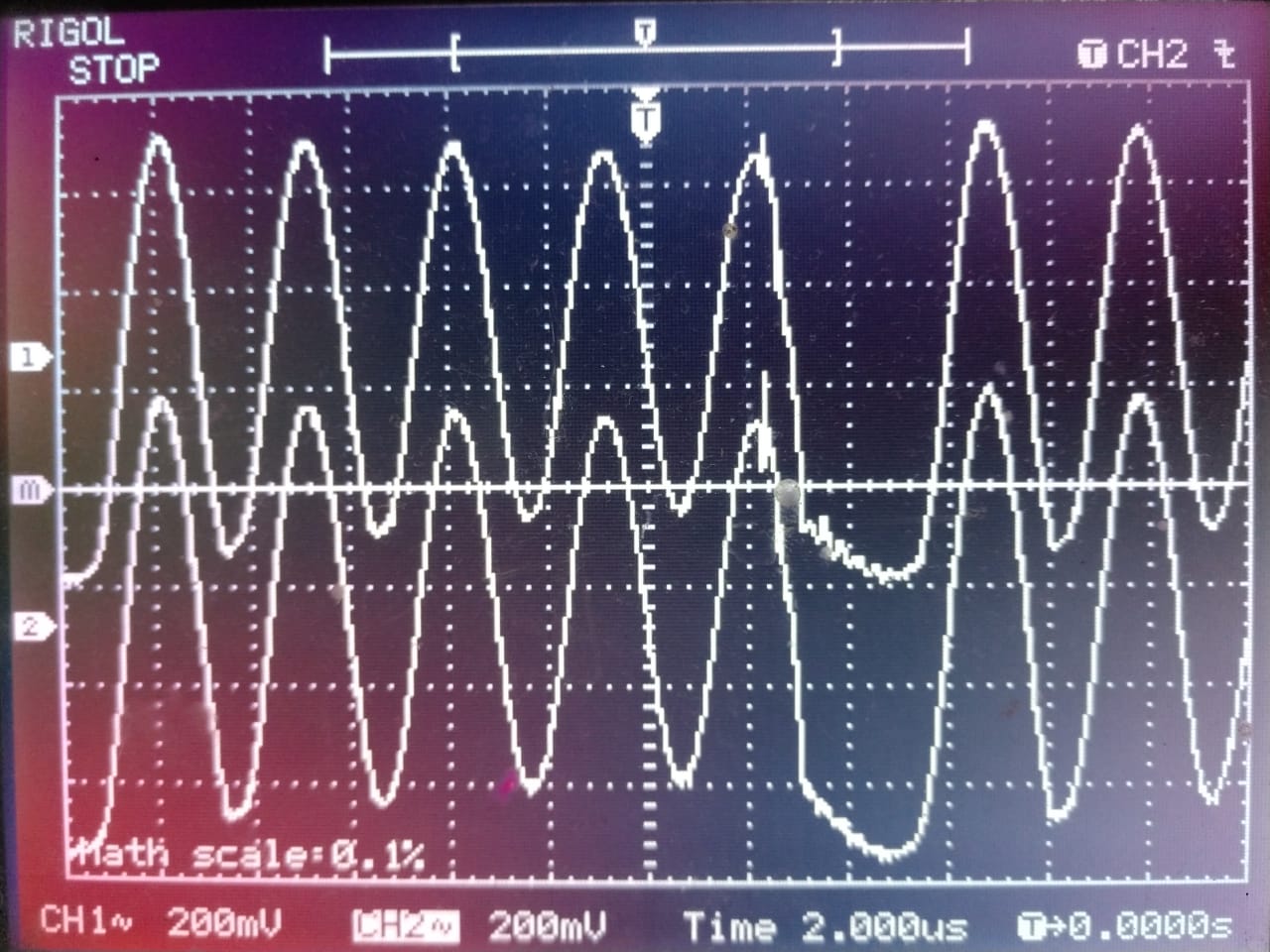

  •  Hello Richard,
    I connected base of the Q2 at LO pin so that propagation delay effect can be nullified.
    yes R12=10K, and R7=2R2 is the series resistance with bias.
    In this present configuration Q1 and D1 are heating but not UCC27714.
    I have attached  scope trace where Channel 1 is between (HO and GND) and Channel 2 is between HS and GND, both are at the same scale and taken when transformer is connected.
    Kindly suggest some reference circuit with parts values mentioned which was tested and running in the two transistor configurations. So that I can start with this.
    Thanks and Best Regards,
    VK Verma
  • Hello VK,
    Thank you for the update on the testing. I have some comments about your latest schematic, and the UCC27714 Figure 49.
    Q1 drain needs to be able to pull down the voltage on Q2 Vgs. The R9 resistor needs to be moved to be between C12 and D3/Q1/Q2 connection.
    Since Q1 needs to be able to pull down Q2 Vgs, increase the R7 diode resistance to higher values to limit the current. Try at least 20 Ohms for R7.
    I have some question about he scope plots, Is the scale as shown as 200mV/division? I would expect high voltage waveforms.
    I would expect more square wave waveforms, but if there is no load, or the secondary load circuit is not connected, this would affect the waveforms.
    Can you confirm the voltage scale, and record waveforms of Q1 VGS, HO to ground, and HS to ground with the same voltage scale and ground reference location.
    Let me know if this helps, or you can post more questions on the thread.
