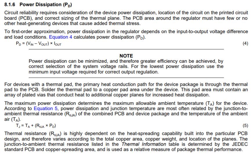

    1. At high current and big Vin and Vout difference, thermal performance will be challenging. Please read through the following chapter to know the limitation on thermals. The parameters mentioned in the following chapters are different for each device and package and they can be found in datasheet.
    2. Once you understand the limitation of thermals, you can start to think how you can improve the thermal for higher current output. There are different ways to do it. Instead of having a output voltage of 5V or 12V from 25V, can you setup a few voltage stages in between by using multiple LDOs? Can you also try to parallel multiple LDOs to increase the output current?  There are applications notes you can find online about how to do parallel LDOs.
    3. When you are dealing with thermals, can you do better PCB layout to have better heat dissipation? Maybe increasing the size of metal for heat dissipation? Can you create more vias on the PCB to improve heat dissipation?
