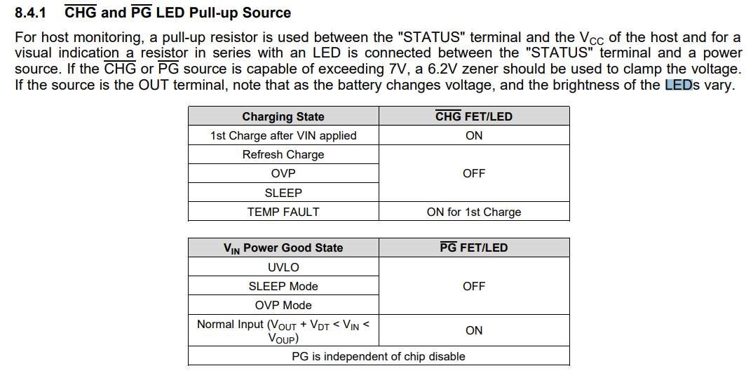

    May I know both BQ24072&BQ24040 support LED function of low battery alarm?
    I cannot see the function in spec.
    Could you explain more about normal input of Vdt and Voup?
    Thank you.
    Daisy Yang
  • Hello Daisy,
    Neither the BQ24072 nor the BQ24040 have an alarm for low battery. They have LED indication for VIN present and also charging and charge complete. Vdt is the detection threshold for when the device considers VIN present. This happens when VIN > VBAt + Vdt. VOVP is the voltage when we turn off the input voltage to protect the charger against high voltages.
