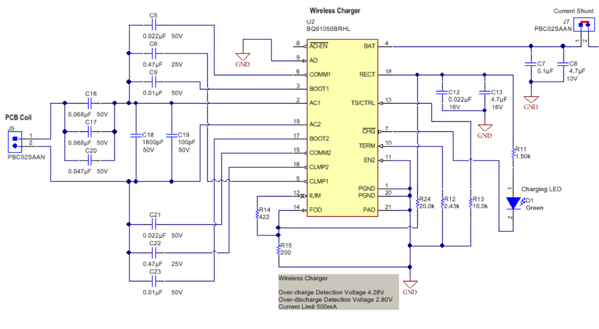

Hi, I have used the following electical schematic to recharge my LiPo battery. The used coil is WURTH model 760 308 103 206 as indicated in your bill of material
The problem is that to ensure the communication between a standard Qi Tx and my WURTH coil, the distance must be 1 mm or less. This distance is too small. How Can I improve this distance (for example to 4 mm or more) only changing any capacitors.

  • Hello Vincenzo
    I did not see the schematic can you resend?
    What tuning are you using with the Wurth 760308103202, C1 and C2 from data sheet section 9.2.1.2.1?

  • Sorry, here the schematic.
    For C1 and C2 I have used exactly the values indicated in the schematic.
    About the coil I cannot use bigger coil because of the small dimension of my device. I can accept the rectangular shape of 29mm x 15mm (760 308 103 206) as indicated in your bill of material

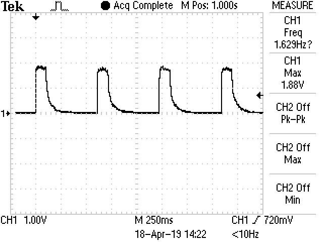

  • Hello Bill. Following you can find some graphs
    Here the voltage on VRECT. As you can notice there is not enough energy to start with the charger

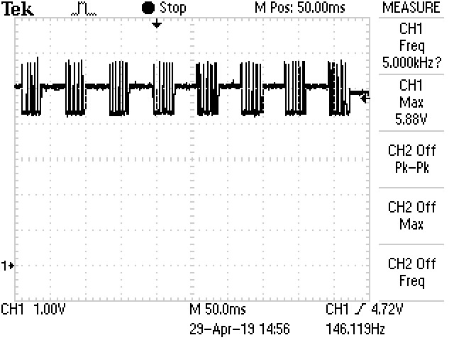

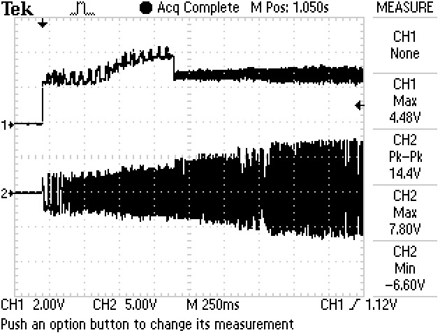

    When I connect the pin 2 of the coil to GND I can measure this trend on VRECT (CH1) and between pin 1 and pin 2 of the coil (CH2). In this way there is communication between TX and RX and my battery is charging

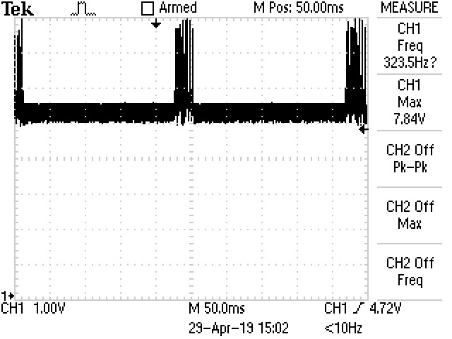

    I have tested again the VRECT without the PIN2 of the coil to GND and following you can notice the increment in voltage of VRECT when I connect the pin2 of the coil to GND

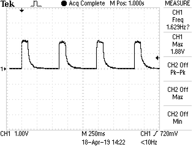

    ----NORMAL (VRECT with pin2 of the coil NOT to GND)
    ----INCREMENT in voltage (VRECT with pin2 of the coil TO GND)

  • Hi Vincenzo
    The first scope capture of RECT shows a 100mS pulse every 600mS, amplitude is less than 2V. As you pointed out this is below UVLO, the RX will not start.
    The 2ed scope capture that shows a start up with coil pin 2 connected to ground. I think this configuration is acting as a voltage double and increasing RECT voltage above UVLO.
    The 3ed scope capture (normal) looks like the voltage is increasing enough for the RX to reply. But communications is poor and when TX decodes the signal an error is detected. TX shuts down then restarts. Time between packets is about 40mS, typical time for a restart after decode error.
    The 4th scope capture looks like the RX reply but no start up.
