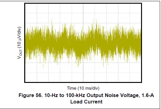

Hello Team,
how can I measure the noise like shown in the TPS7A8300 data sheet figure 56, please? It looks like an oscilloscope plot? How did you filter the signal?
Thanks and Best Regards,
Hans
  • Hi Hans,
    You are correct this is a oscilloscope plot zoomed in on our output signal. Due to the low magnitude of the noise, you will likely need to gain the output to make sure that you are above the noise floor of the scope. In order to capture the bandwidth you will need to use a bandpass filter on the output. The following training video discusses a few more steps to make the most accurate noise measurement:
    training.ti.com/ti-precision-labs-op-amps-noise-7
    Please note that we generally make our noise measurements using a Spectrum Analyzer. The following White Paper details this process:
    www.ti.com/.../slyy076.pdf

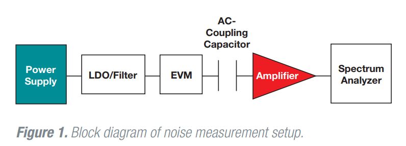

  • Hi Ryan,
    thank you. But what kind of input voltage source did you use? This also adds noise to the output, correct?
    Hans
  • Hi Hans,
    Yes you are correct.  For a linear regulator, when we discuss noise we are referring to the noise that is generated by the regulator itself.  This noise primarily comes from the reference of the regulator.  Power supply rejection ratio (PSRR), also known as ripple rejection, is a measure of the LDO’s ability to filter ripple on the input rail.  Noise sensitive applications require a “clean” output rail.  As such they require low LDO noise and high PSRR.
    As such in order to measure noise, you are exactly right that we would want to use the cleanest input supply possible so that we are only measuring the self generated noise.  While a battery can sometimes be used as the supply, this is not always practical for the application conditions that you want to test.  As such, we will often use a bench supply and then filter it before the Device Under Test (DUT) which would commonly be on an EVM as shown in the block diagram below.  This filtering can be done using passive components or even using the PSRR of an additional LDO.  You will want to be sure to measure Vin local to your DUT to account for any voltage drop in your filtering method.
    While the above block diagram is from the white paper provided in my previous post, the same exact process would be used for a oscilloscope measurement.
