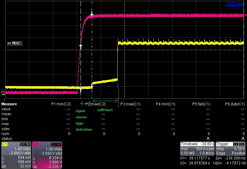

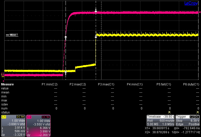

my customer test on our EVM with 5V DC source, no battery, no load on VSYS.
When D+ D- floating, the SYS will reach VSYSMIN about 0.78s later than VBUS reaches 5V. Shown below: (red-VBUS, yellow- VSYS)

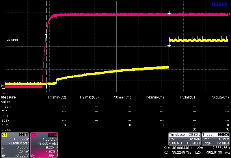

When D+ D- shorted, the SYS will reach VSYSMIN about 2.75s later than VBUS reaches 5V. Shown below: (red-VBUS, yellow- VSYS)

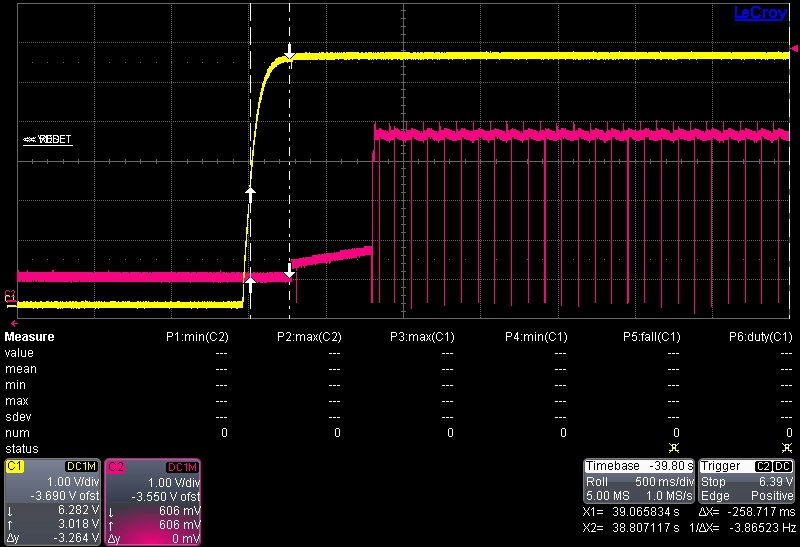

This should not be related to the process of INPUT SOURCE TYPE DETECTION because both converter started switching about 258ms later than VBUS reaches 5V shown below which means the INPUT SOURCE TYPE DETECTION finished within 258ms.

    In your first plot, did you mean to caption with "D+/D- shorted" not floating? If so, then D+/D- shorted, results in maximum input current limit while D+/D- floating results in 500mA current limit. At startup, the charger has a short start circuit. If that circuit is clamped to 500mA, then the SYS rise time at startup will be longer.
    Jeff

    It's D+D- shorted which will lead to longer soft start time, not the other way around.
    And the input current limit should be neither 500mA nor 3.25A during soft-start period.
    According to the datasheet: When the system rail is below 2.2 V, the input current limit is forced to the lower of 200 mA or IINLIM register setting.
    So in fact no matter how D+ D- is configured, the input current limit should be the same as 200mA.
    But when D+ D- shorted, the (soft start time + input source type detection time) is much longer than when D+ D- floated. And the difference is caused only by soft start time, not input source type detection time.
    It happens on our EVM and it's not explainable, we want to know what kind of configuration of D+ D- could minimize the soft-start time.
  • Howard,
    Soft start continues until VSYS=2.2V. Input source detection times are different if D+/D- is shorted or floating. With HVDCP enabled, DCP detection can be as long as 2s. Can you repeat the measurements and show the INT pulses and SW node? The first INT pulse shows poor source detection complete, the second pulse shows input detection complete and the third shows VINDPM complete if relative VINDPM on.
    The shortest detection time is USB BCP1.2 SDP (~250ms startup time + ~80ms). Can your customer add resistors on D+/D- to simulate an SDP port? This will limit input current limit to 500mA after soft start.
    Jeff

    1.The startup is dependent on the input detection time. The converter always starts after the input detection is complete
    2. SDP has relative faster startup time.
    Ning.
  • Jeff,
    I want to confirm that we can still change IINLIM to a larger value like 2A with software after simulating SDP port, right?
  • Howard,
    Yes.  You can change the IINDPM via I2C after input source detection completes.
