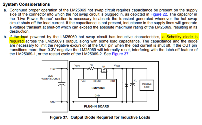

As my customer use LM25069 as the overcurrent and short current protection device, but we find the device OUT pin is easy to be damaged, and we find there is a negetive spike voltage(<<0.3V) when do the short current test.
I go thru your old E2E threads, you recommended to add a 1k resistor on the OUT pin and a shotkey diode in parallel. We do so, it works in 50A current, but because the customer actual design demand is to protect a 100A overcurrent, then the dI/dt would be very big. then the OUT pin still would be damaged.
I want to know, if we replace the 1k resistor with a diode is a good idea to prevent the negetive spike goes lower than 0.3V under the worst scenario? Thanks.

    Schottky diode is needed to clamp the o/p voltage going to -ve side during fast cut-off events.

    As mentioned in the datasheet, a schottky diode is required for inductive loads.
    A schottky diode which has 'Peak Forward Surge Current' greater than the maximum fast current  trip threshold of your design needs to be selected.
