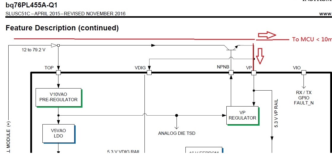

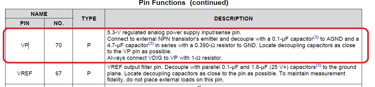

For 50S solution, I am trying to leverage PL455 x4pcs for this design. However, we need to apply 3.3 V to MCU. In EM1402, the power is applied from external USB.
I am thinking if there is any LDO or others from PL455 for this purpose. Could you give me your comment?
