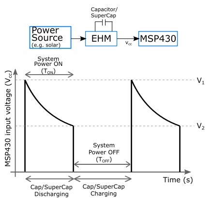

I have a MSP430, and power source (e.g. solar), I want to provide the MSP430 with the EHM ouput power supply as shown in the figure below.
The EHM would be something similar to the BQ2550xEVM component, which can harvest energy, boost the voltage, charge an energy store and control the power output to the load.
The EHM will be need to setup with a Capacitor / Supercapacitor. The EHM will provide an output to the MSP430, when the supercap reaches a voltage V1, and cut off the power when the supercap is discharged to V2. These thresholds should be something like :
V1 = 3.3V, V2 = 1.8V
1) is there a TI power/energy management / energy harvesting component I can use to get the above EHM behaviour ?
2) The closest i'm found is the BQ25504-EVM/BQ25505-EVM series, but I'm not sure if the above V1, V2 can be set in those units, can their voltage thresholds be adjustable easily ?
