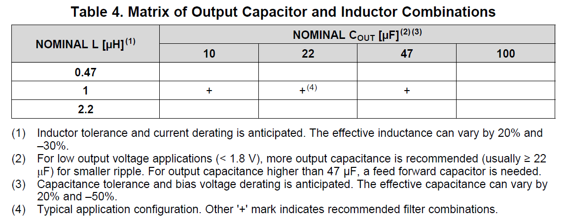

Hi Pals,
Could I use output capacitor value 330uF+100uF for TLV62585 ?
I am worry about that it will trigger OCP function because the soft start is the internal function for TLV62585.
What is the max output capacitor value could I use to design in TLV62585 ?
My design condition as below:
Vin=5V, Vout=1.0V, Iout=3A
Vin=5V, Vout=1.2V, Iout=3A
Vin=5V, Vout=1.8V, Iout=3A
Please help to confirm it. Thank you.
