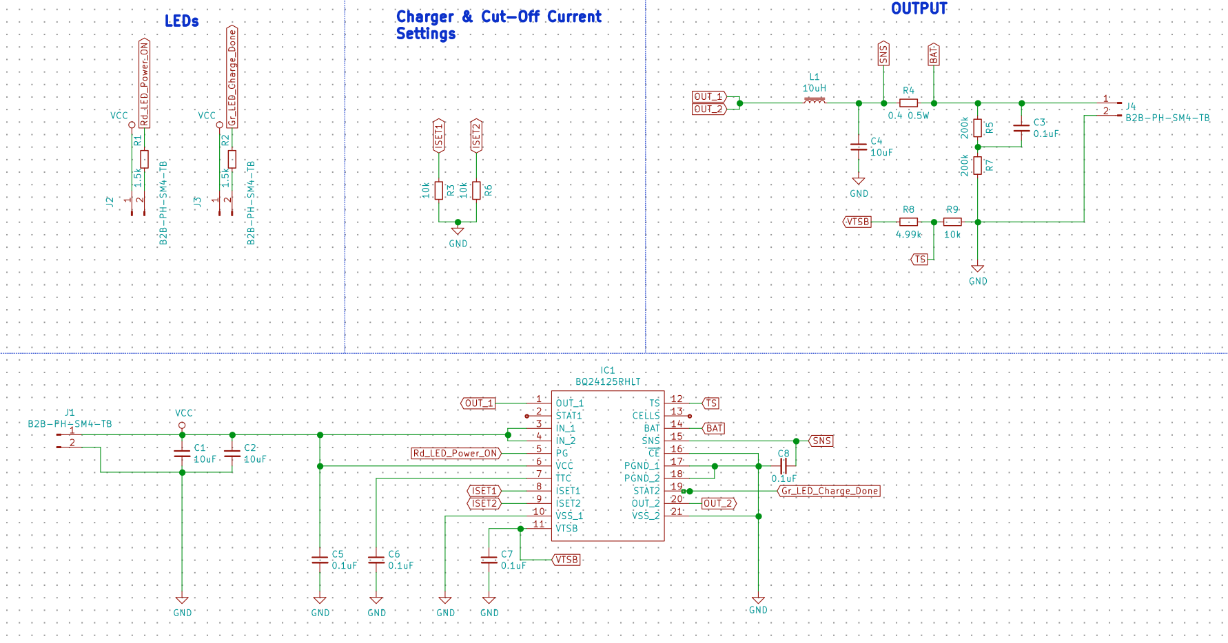

BQ24125: Please review my schematic.
Part Number: BQ24125
Dear TI community could you please review the schematic.
actually this is quite the same as reference design of bq24125EVM-003
I_charger = 0.23 A
U_charger = 12.6 V
Thanks a lot.
regards,
Mike
  • Michael,
    I am not seeing an attachment.
    Jeff
  • I'm sorry Jeff,
    there it is.
    Mike
  • Michael,
    I noticed the following:
    1.  Is the mid point of R5 and R7 supposed to connect to pin 13 CELLS/FB?  If so, for 12.6V, R5 needs to be 2X R7.  Equation is VBAT=2.1V *(1+R5/R7).
    2.  Does your battery have a thermistor?  If not, R8 and R9 need to be sized so that TS see 1/2 of 3.15 volts.
    3.  Your ISET resistors are close the values for your desired charge and termination currents but slightly below.  Choosing resistors closer to the calculated value per design equations 17 and 18 on datasheet page 4.
    4.  I recommend adding a pull up resistor (maybe LED) to STAT if for no other reason than to help debug issues.
    Jeff
  • Hi Jeff,
    - It's just the voltage divider thank you :-). Also forgot to connect it. For 12.45V, I choose 49.3k and 10k with 0.1% tolerance. Shouldn't they both be quite precise and also thinfilm?
    - both are 10k now.
    I_Charge = 100 mV / 0.43 Ohm = 0.233 A
    RISET1 = (1000 x 1.0) / ( 0.43 Ohm x 0.233 A) = 9981,01 -> 10 kOhms
    RISET2 = (1000 x 1.0) / ( 0.43 Ohm x 0.233 A) = 9981,01 -> 10 kOhms
    is there anything wrong with this?
    very good idea. thanks.
  • Michael,
    Precision resistors improve accuracy but most people use 1%. I used the wrong SNS resistor in my ICHARGE calculation. Your calculation looks correct.
    I see no other obvious errors on the schematic.
    Jeff
  • Thank you.
    Mike
