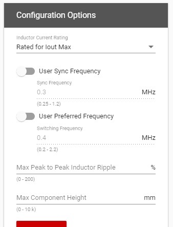

  • I saw that, but, while it does not imply that you can't  run the fixed versions at 2.1MHz via the Sync pin, it also doesn't necessarily mean that you can (since obviously min on/off times at the sync input are are only one possible limiting factor on frequency).
    Also, interestingly, the Webench configurator allows a user frequency of up to 2.1MHz on the adjustable parts, but allows a Sync frequency of only up to 1.2MHz, but on both the adjustable and the non-adjustable parts (which directly contradicts the datasheet at least where the adjustable parts are concerned, which says they can sync up to 2.2MHz). The max sync frequency I guess is simply wrong in Webench.  The fact that Webench allows the fixed parts to be Sync'ed up to the same frequency as the adjustable parts is encouraging, but it would still be better if the datasheet explicitly stated the functional range of the sync pin on the fixed parts rather than simply implying it.
  • Andrew,
    Thanks for pointing this out. I'll get in touch with the WEBENCH team to clear this up.
    Thanks again,
    -Sam
  • Andrew,
    We have fixed this internally. It will reflect online after our next refresh (a couple weeks). Thanks again for pointing this out.
