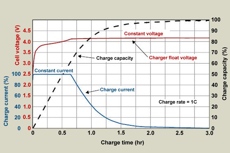

I'm using the LM5176 to design a CC-CV battery charger for a Li-ion battery. The battery ranges from 39V to 55V. The output of my AC-DC power supply is 48V DC. I have a couple of questions
  1. What will the CC-CV curve look like if I don't bias the FB or ISNS pins? Will the charge current taper as the battery voltage approaches 54V and enters C mode?

  • What I mean is, if I have a voltage divider connected to the FB pin and a current sense resistor on the ISNS pins setting the average output current, what will the CC-CV curve look like if I used this curcuit to charger a Li-ion battery.

  • I see what you mean. The I-V curve under CC-CV control looks like the typical, which is a rectangular shape: when the voltage is blow the regulation level, the circuit has the constant current. When the voltage reaches the setting point, the current falls vertically.

  • When it fall vertically is that a sharp drop or is it a tapered gentle slope towards 0A? And if so, at what rate does it lower the current?

    (1) the charging current will look like what you show in the graph. When I say falling vertically I meant in an I-V curve, with "I" in the x-axis, and V in the y-axis.
