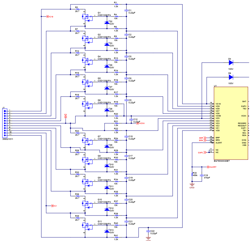

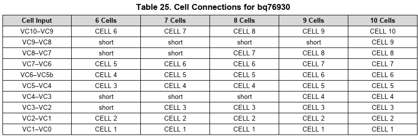

Hi everyone. I have a few days reading this forum, found several themes, but the information is divided. The question is how to properly connect unused cells, when the number of series cells in the battery decreases. I used the BQ76930, a battery 8S, in accordance with datasheet on BQ769x0 (SLUSBK2H ) need to short a cell VC3+VC4, and VC8+VC9.
I fulfilled those conditions.

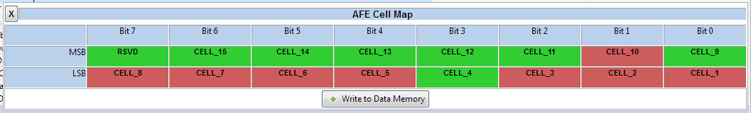

Here's mine AFE Cell Map

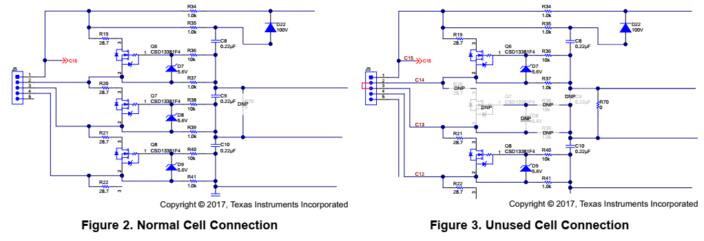

Then in one of those on this forum, I've read, that unused components can distort measurements.I have removed unused components according to the following document. Here is a picture from the document TIDA-00792 (TIDUCN1), page 5, paragraph 2.2.1.
As a result, the balancing on cell 5 and cell 10 stopped working, I tested the balancing command with command 0x001B. Now I ask you to turn to the scheme.This is how it looks initially.

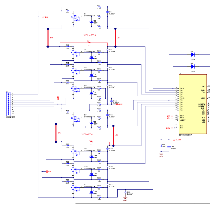

And so after revision in accordance with the document  TIDA-00792 (TIDUCN1).
I deleted components R28,Q8, D10, R30, R31, C17 for point VC3+VC4, and components R7, Q2, D3, R9, R11, C2 for point VC8+VC9. Then I set the jumpers JP1+JP2 for point VC3+VC4, and jumpers JP3+JP4 for point VC8+VC9 (As jumpers were 0 Ohm resistors installed instead of capacitors C2 and C17, respectively). Cell balancing vc5 and VC10 still didn't work.
Then I installed the resistors R9 and R31, remove jumpers JP2 and JP4, and balancing has work. But it contradicts the document TIDA-00792 (TIDUCN1), since now there are no jumpers on the terminals of the chip, and there are filter resistors R9 и R31.Will not do this error of measurement? Advise how to connect correctly.

    When we short the cell inputs (VC3+VC4 and VC8+VC9 in our example), we connect two filter resistors, and two inputs of the BQ769x0 chip connected in parallel, to one battery cell. I'm worried that it might affect the accuracy of the measurements, and possibly cause a slightly faster discharge of the cells connected to this parralel inputs?
  • Hi Alexey,
    It looks like your AFE Cell Map is set up correctly. You should remove R9 and R31 - these should not be connected.
    The problem with the Cell Balance Toggle command (0x001B) is that it does not reference the AFE Cell Map. It will simply toggle the odd cells and the even cells without knowing how things are connected externally. For your configuration, I would avoid using this command.

    Let me ask one more question. If we use BQ76930 for configuration in 6S mode, we must short the cell VC3 with cells VC2 and VC4, and cell VC8 with cells VC7 VC9 respectively.
    Let's take cells VC3+VC2+VC4 for our example.
    Each of cells has its own filter components, mosfet and bypass resistor. Shorting the inputs of the cells together, we essentially get one cell instead of three.
    The unnecessary components of some two cells we need to remove. The components of one of the three cells we have to leave. Components which of the three cells is better to leave?
  • Hi Alexey,
    Yes, JP2 and JP4 should be installed when reducing the number of cells to 8.
    For the 6S case you describe, it should not matter which cell you leave the components for since you will be shorting the VC2,VC3,VC4 pins and the cell connectors for these cells.
    Matt
  • Hi Matt. I checked the balancing by artificially causing an imbalance of 4 and 8 cells, I removed the resistors R9 and R31, re-installed JP2 and JP4, and checked the work of balancing on the outputs of the BMS VC5 and VC 10. Balancing really works, thanks for your advice.
