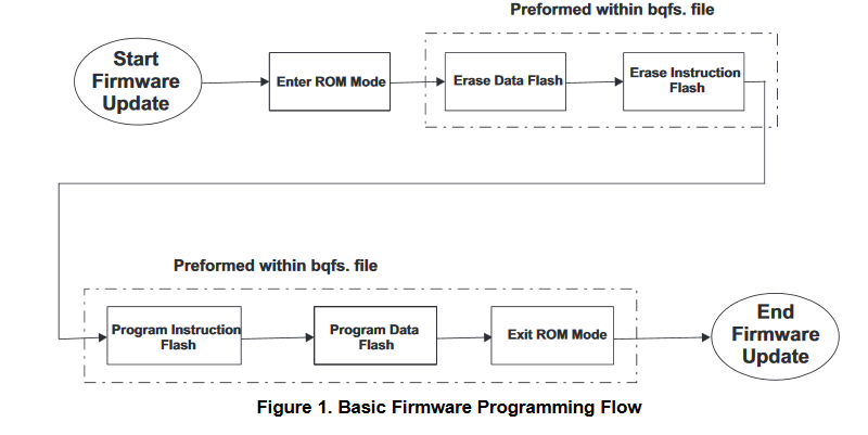

Hi Onyx:
    As you know we had one fail Fuel Guage that caused I2C bus didn't work. This Fuel Gauge was sent back to TI to do FA process. There was a discovery that Instruction flash is blank. And it recovered via loading srec file. So I have some questions based on this.
1, The reason causing I2C bus doesn't work and hang is IF blank. Is my understanding right?
2, How does IF become blank during update? What reason and process?
3,What steps are need to update FG via dffs file?
4,Is deadband change stored in 'Instruction flash' or 'Data flash'?
5, Update bqfs file flow is like below. And I attach data transformation file(it is got from I2C analyzer) using EV2400 and bqfs file. Cloud you tell me when does erasing Instruction flash happen in attached file? I want to the exact  time to erase IF.update FG using EV2400 and bqfs file.xlsx
