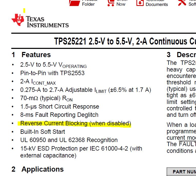

My customers are reviewing to use TPS25221DBVR.
Only the brief text of "Reverse current block" is shown on Datasheet of TPS25221DBVR as below.
The AP2553W6-7 from diodes, a competing part, provides a detailed description of the reverse current block as shown in the datasheet below.
Can you give me a more detailed specification like this?

  • Hi Anthony,
    As datasheet indicates, we have the reverse current blocking function when disabled.
    Don't guarantee RCP as enbled.
    The principle as following:
    Can you kindly tell me the application scenario of customer?
    Customer must need this function as enabled?
