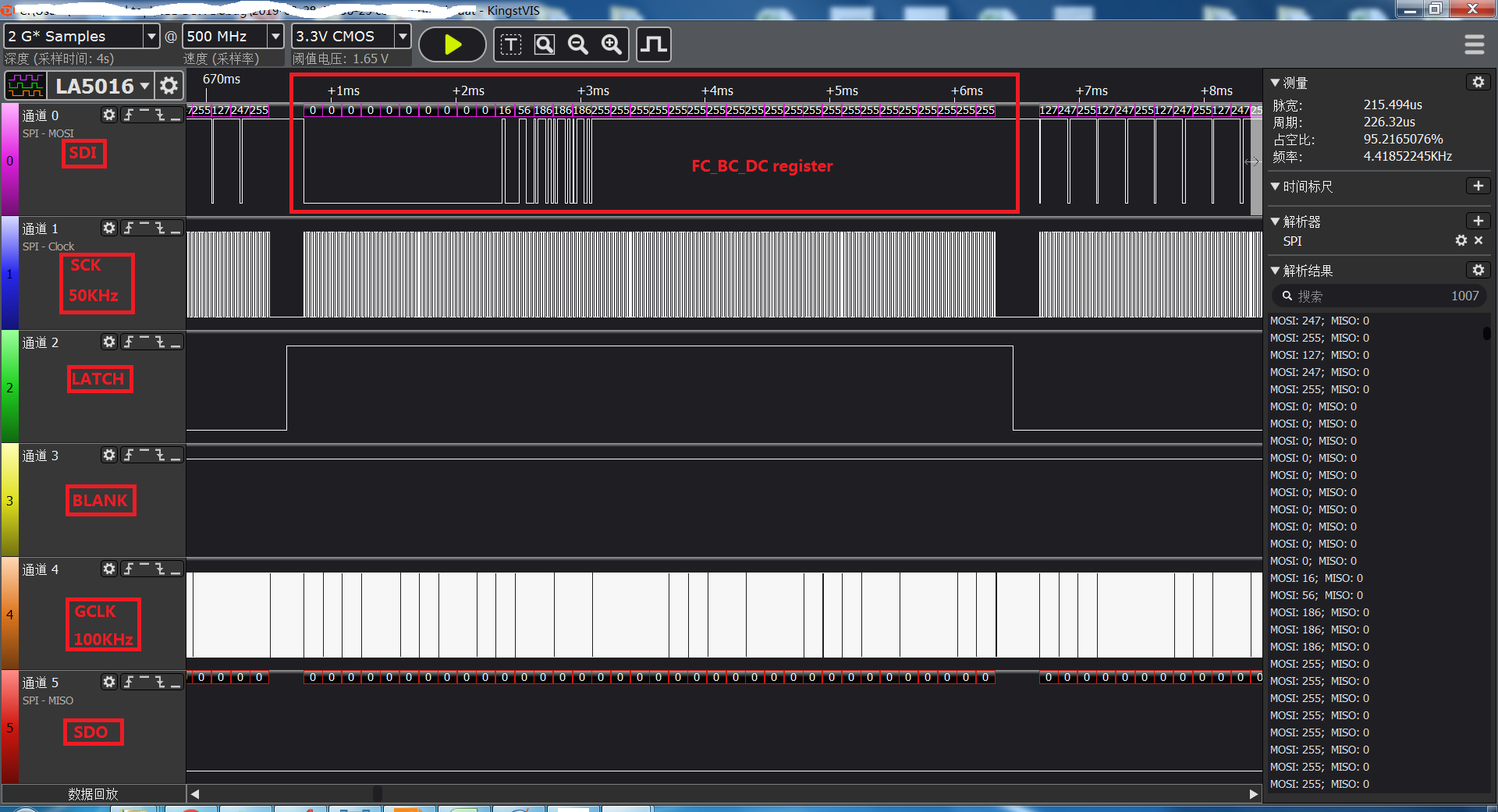

Hello TI,
I made MCU send SPI signal to drive TLC6C5724 EVM, but the EVM could not be lit and the SDO port had signal transfer. The following is the signal I captured. Please help me check what was wrong.
(PS: The signal data that I sent to the register(GS or FC_BC_DC) was copied from the TLC6C5724 EVM GUI which can successfully light the EVM.)
