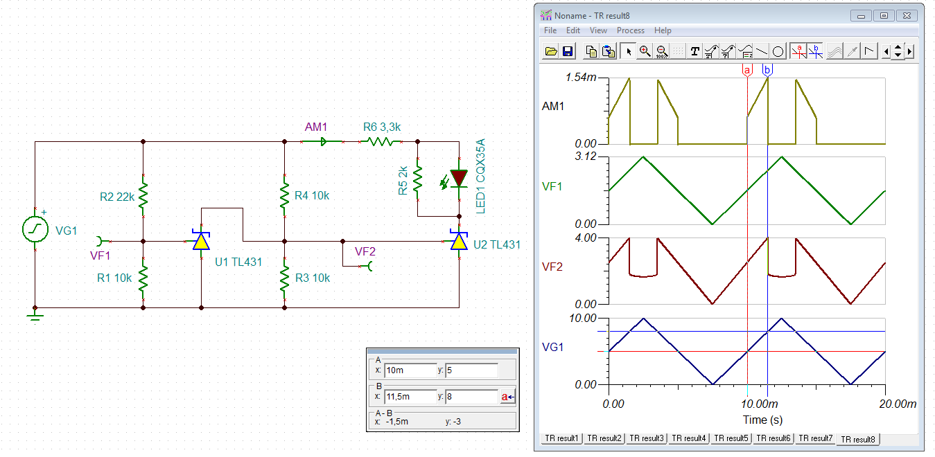

    this simulation might answer some of your questions:
    wenhao2.TSC
    Kai
  • Hi Wenhao,
    Kai's simulation helps show the functionality of the circuit.
    In regards to your questions.
    Yes the REF pin will sink current to keep the VREF around 2.5V. There is no ABS max voltage because its more of a CV until the ABS max current is violated. The TL431 VREF will be between 2.5V and ~2.6V when IREF is below 1mA. I would recommend to keep IREF below 1mA even if ABS max is 10mA. It is possible to design 1mA limit because you know the voltages on both sides of the R1B and R1A.
    -Marcoo
