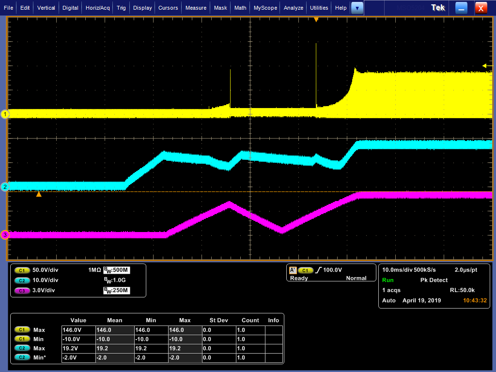

We use UCC2897A for spec Vin is 54V and Vout is 12V.
PQ8 will be damaged. The fail rate is about 280/7000(4%).
Ch1: PQ8 VDS
CH2:VDD
CH3: SS
When power on, there are 2 spikes on PQ8 VDS.
Do you have any suggestion for this case?

Thank you for your reply.
We still have some problems.
Could you kindly help to describe or draw the path of reverse current.
