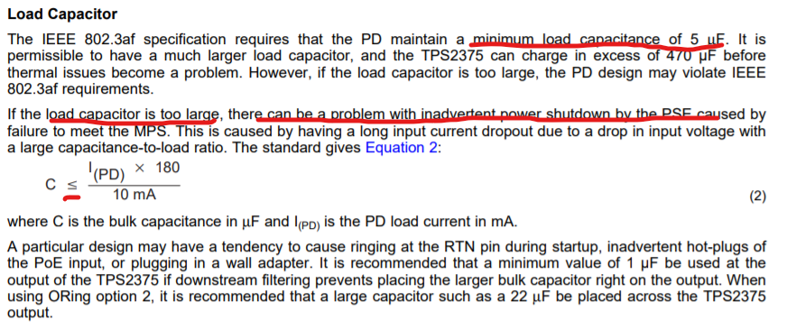

I was looking for assistance in choosing a load capacitor for the TPS2377 PD.  Looking on page 16 of the data sheet it provides a formula for determining the right capacitor value.  Any value I look at comes to about an order or two of magnitude larger than the maximum that is recommended (470uF).  Is there an updated formula or am I just calculating it wrong?  Downstream of the capacitor will have a 15 W DC-DC converter which will probably draw around 5W of power.

    I assume that you're referring to equation 2 on page 16 of the TPS2377 datasheet. That's actually an equation for the maximum cap not recommended cap. For your power level you will usually wind up with a much smaller capacitor than 470uF.  Note that the input cap depends on the DC/DC.

    That is the formula I was looking at.  The equation calls for the Load Current (in mA) which (when looking at our DC-DC converter) is drawing a maximum of 15 Watts (54V * ~277mA).  Plugging the 277mA into the equation referenced under load capacitance comes up with almost a 5 mF cap.  Nominally we are drawing around 5 Watts (54V * ~92.5mA) which drops the capacitor to requiring 1.67 mF cap....much greater than the maximum recommended capacitor of 470uF.

    Take a look at the snapshot from the TPS2377 datasheet. The formula is for MAX  capacitance not "recommended cap".  You do not have to use 1.67mF. It just needs to be lower than that and greater than 5uF.

    Ahh I understand now.  What capacitior would you reocmmend then for my application of a nominal 5W load?  I understand between 5uF and 470 uF but would there be a benefit of using a larger vice smaller?

    Smaller cap gives you a smaller solution size and lower BOM cost. A larger cap will reduce the input current ripple and provide a stable supply for your DC/DC. In this cap is a part of DC/DC design.
    For your reference we typically use something in the 10uF - 47 uF for our PD+DC/DC designs. For example TPS23755 EVM uses a 10uF cap. Any reason you're not considering an integrated PW + PWM IC such as TPS23755? You can just copy paste our EVM for a fast design. :)
