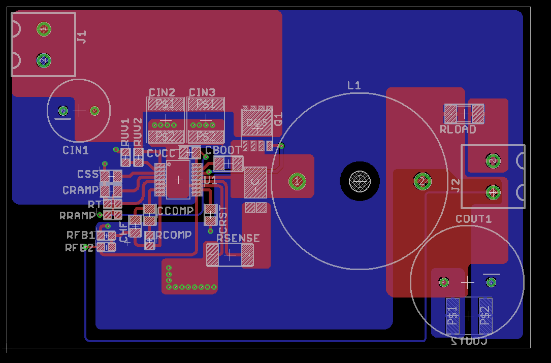

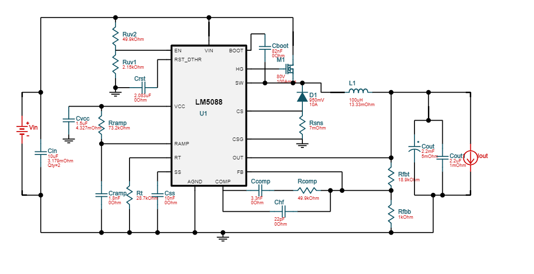

    Here is the schematic for the circuit board
  • Michael,
    Your clues make me think this may be a stability issue. Check if the output voltage is stable. The whine may be at the frequency of the output instability if this is the issue. In this case you will need to use the quickstart calculator to recompensate Rcomp, Ccomp, and Chf.

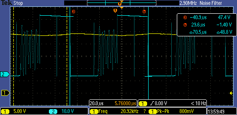

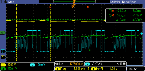

  • I connected an osciloscope to the load and the output was fairly stable at about 800mV peak to peak. I did find the frequency of the output to be ~8kHz at a 1A load and ~25kHz at a 2A load.
    I checked the switching frequency at pin 13 and found the frequency to be about 15kHz and there was some noise mixed in.
    Yellow is the 24V output and blue is pin 13 in the IC (SW)
    I'm having trouble downloading the quick start calculator, I get a site maintenance warning when I try to download the calculator.

    This is strange. With an RT resistance of 28.7k you should expect a switching frequency of around 200kHz to 250kHz. I believe the issue is stability. Please recompensate using the excel calculator (direct link here and attached below).

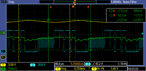

  • This is after switching the compensation filter to 25kHz per the quick start calculator.
    The load is currently ~2.4A but when I step it up to ~3.6A the power supply starts to shut off. I've lowered the Rsense to ~7Ω so I don't expect it to be an over current situation,
  • Output with the 15kHz compensation circuit.
    2.4A load
  • Michael,
    You should expect a switching frequency of around 220kHz. Please recompensate for a frequency of 220kHz. The lower frequencies (15kHz, 25kHz) are the frequencies of the instability which we are trying to eliminate.

    I took a closer look at your layout. Here are my comments:
    1. Try cutting the CSG connection to the power pad. This and CG should have differential routing to the sense resistor which your layout does, but this connection to the GND plane under the IC corrupts this measurement.
    2. Try placing a 1uF ceramic cap close to the VIN pin of the IC connecting to the GND plane just above the IC to the left of CVCC
    3. The thermal pad should have vias. This helps with heat but more importantly provides a more direct path to the GND pin of the IC. Right now all return current must travel through the bottom layer to the CIN2 and CIN3 vias, then to the thermal pad to the GND pin of the IC.
    4. The placement of the RSENSE GND with relation to the CIN cap GND makes a large return path --> large loop which is bad for this high di/dt loop (adds inductance, ringing, overshoot, and possible coupling).
    5. Same issues as 4. but for the COUT GND. That's a long path which creates a large loop. It would be better to have a path directly back on the bottom layer.
    6. Is there a trace under the RT resistor? Make sure this is not connected where it shouldn't be.
    There's only so much you can do with those notes on your current board but they are worth considering for debug and your next spin.
    -Sam
  • for points 4 and 5, the final version of the board will be a 4 layer board instead of a 2 layer board. This will result in a large ground plane.
    That should solve those potential issues, right?

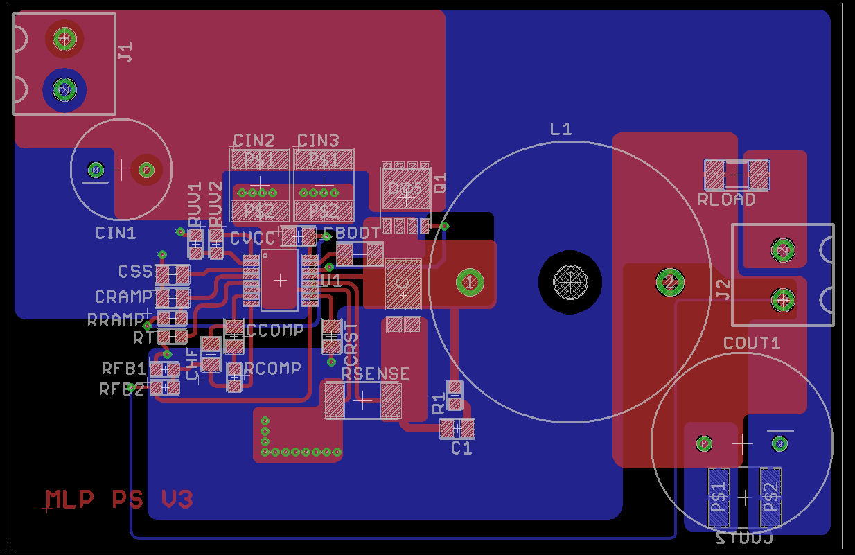

  • This is the current board I am working with, I cut the CSG trace to the ground plane underneath the chip. I'm not getting the 24V output that I expect. Instead I am getting 4.2V with a very small load and that drops down further as I increase the load.
    R1 and C1 are currently not being used. They are there in case I need to add a snubber circuit.
  • Michael,
    Please try cutting the trace connecting CSG to the GND plane under the IC. This is probably messing with the current sense.
    Please confirm you've soldered the thermal pad to the IC.
    -Sam

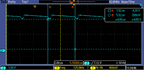

  • The blue signal in the previous image is the voltage at pin 13 of the IC.
  • Michael,
    Pin 13 is the switch node. This should be a square wave from 0V to VIN. There's something going on with your circuit but I'm not sure what it is.
    I recommend going back to WEBENCH and exporting a simulation file. Then check each pin and compare with your design. Which pins are not behaving as expected?
