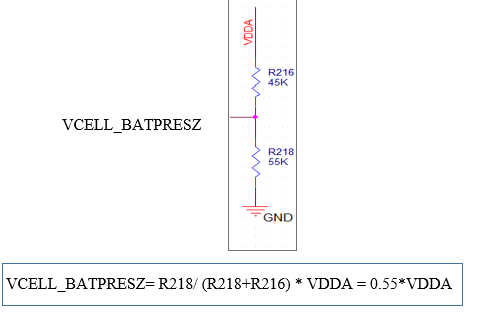

In my aplication the power of th bq25703a 12V et the battery is 12V .
for the configuration the number of cell how I do it
I choose 3S (VCELL_BATPRESZ= 55% VDDA)     ?
  • Hi Belhaj,
    The device pre-configurations assume lithion ion cells and sets them for a charge voltage of 4.2V per cell. If these default settings are not exactly what you need, you would choose the closest available and then use a uC to reprogram the default values over I2C.
    Your resistor-divider looks good. Based on your description, everything in the post looks correct.
