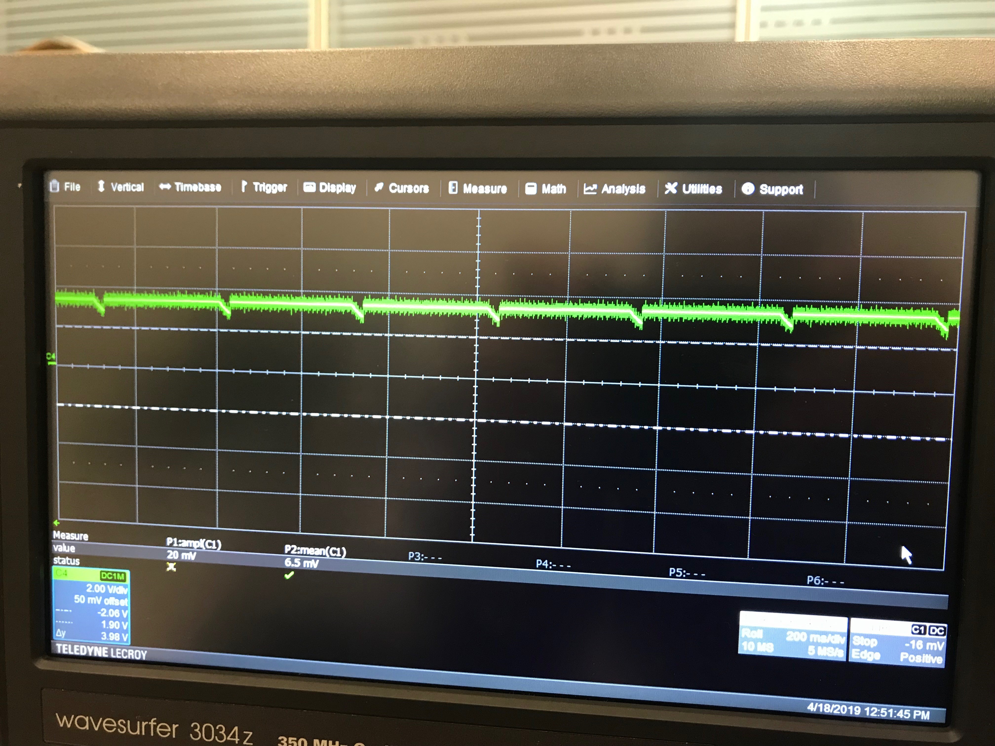

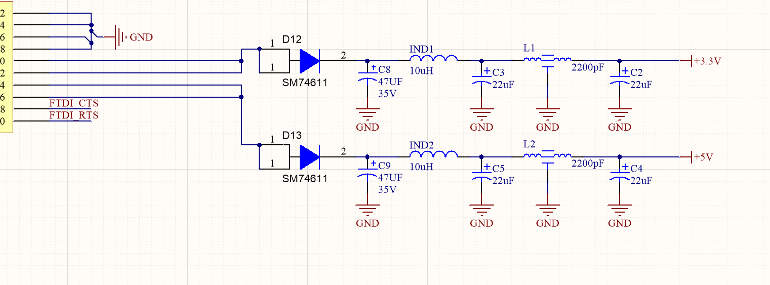

We used the SM74611 diode for our voltage regulation application for single board computer. It needs 3.3V and 2 ampers for operation. Single board computer couldn't start because of the voltage switching. I added the scope image for voltage in.
In the datasheet lowest voltage is 1V, so I think it should work fine with 3.3V.
Thanks!
