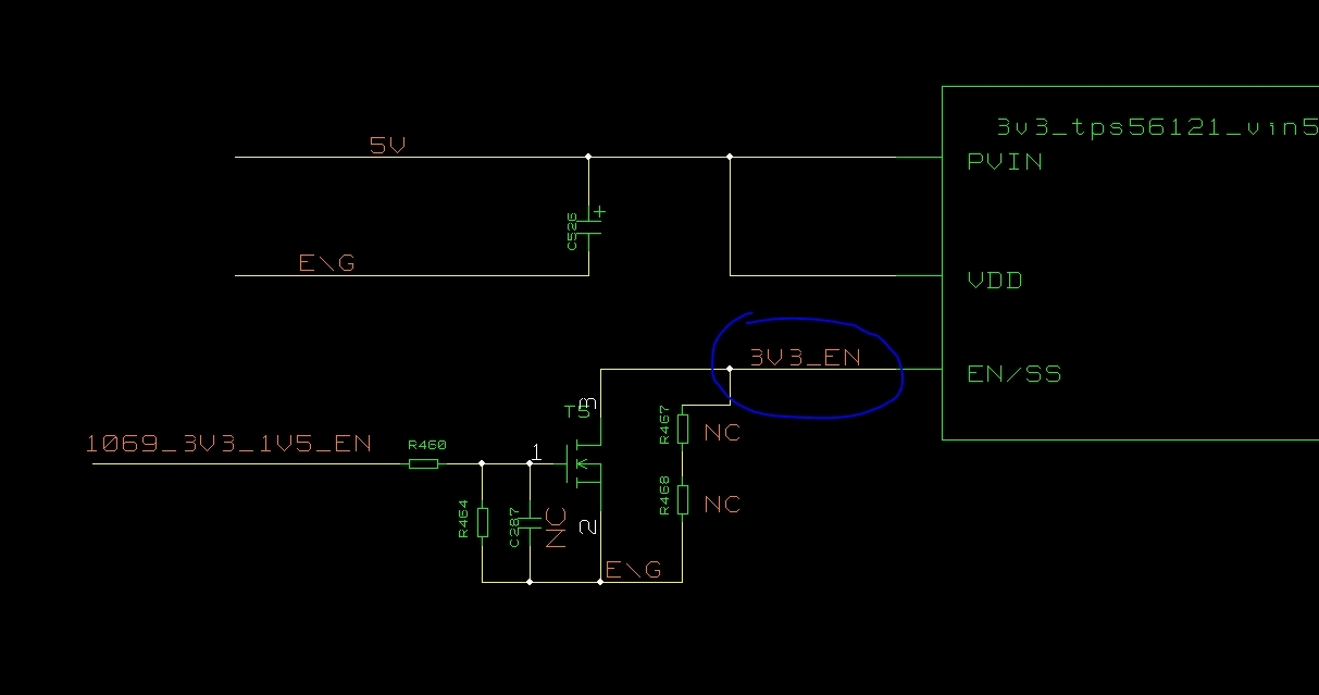

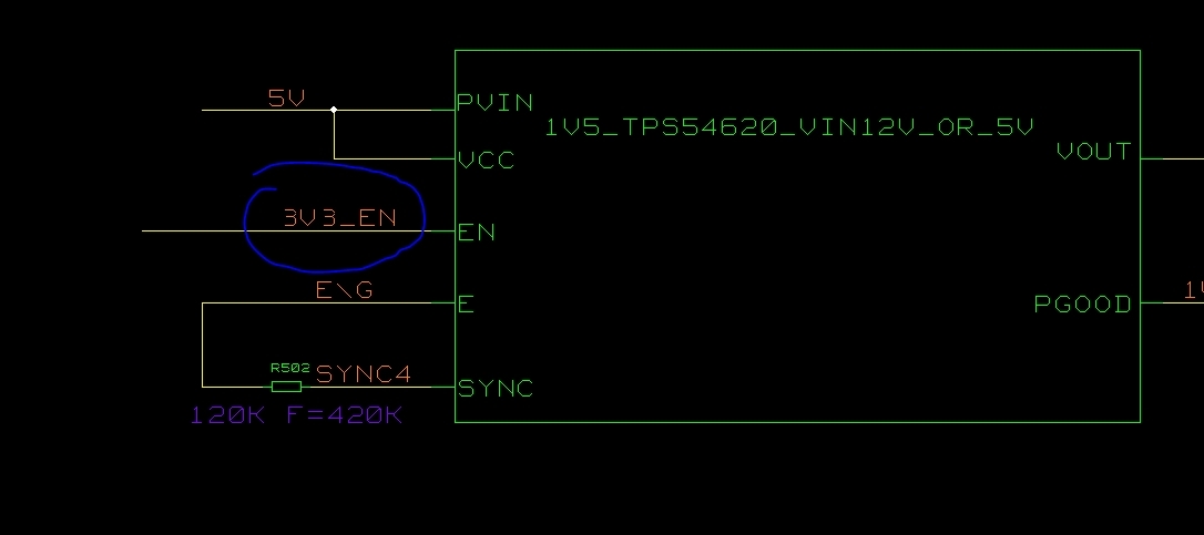

TPS54620: connect EN pins together with TPS56121
Part Number: TPS54620
Other Parts Discussed in Thread: TPS56121,
My customer connects EN pins of tps54620 and tps56121 together. I think it is fine as both have internal pullup current source,which can be paralleled, in Function Block Diagram of datasheet. Could you pls help confirm if there is any risk for the actual inside circuit?
Thanks.
