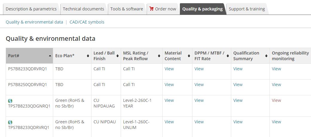

Hello.
Product Name: About TPS7B8233QDGNRQ1
Can I get a reliability data sheet?
I need data when the output is 3.3V.
To do circuit design.
We apologize for the inconvenience but thank you.
  • Hi ,
    We provide Quality, Environmental, and Reliability data on the Quality & packaging tab of the product folder.
    Very Respectfully,
    Ryan

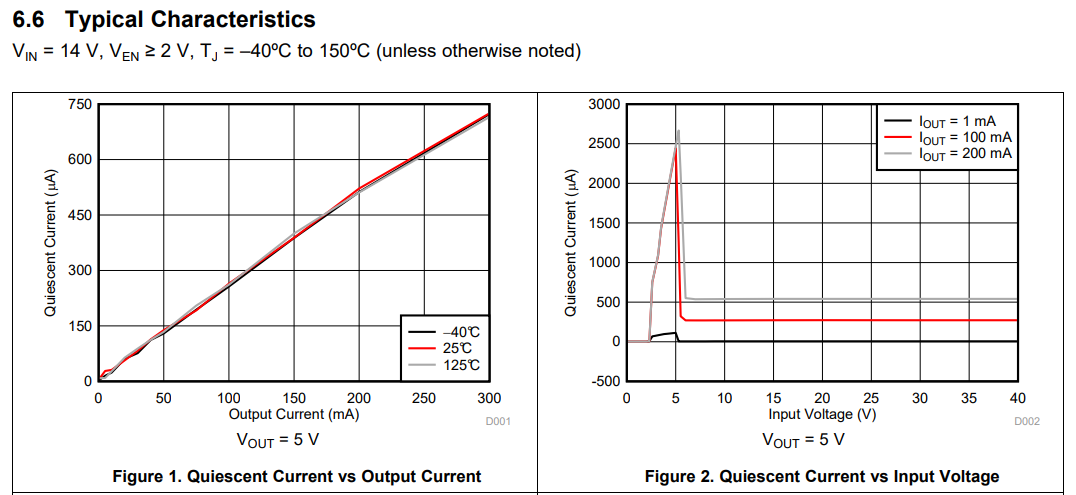

  • Hello.
    Thank you for your reply.
    There was a defect in the content of my question.
    The content of my question is described in the data sheet
    It means that I want various data at Vout = 3.3 V of "Typical Characteristics".
    Can you confirm it? Thank you in advance.
  • Hi ,
    The only difference between the 5 V and 3.3 V output versions of the TPS7B82-Q1 family is the internal resistor divider ratio. As such, the Typical Characteristic curves are representative of both the 5 V and 3.3 V versions.
    A few curves such as Figures 7 and 8 show the output voltage on the y axis. These curves still show the trend for the 3.3 V version; however, you would use a simple ratio to convert the output to 3.3 V.
