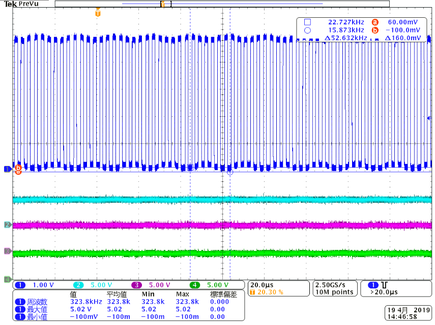

Customer have a issue the switching frequency issue at shorted between -5V and GND.
Please refer the following waveform.
Switching frequency = 323.8kHz
Superimposed frequency = 52.63kHz
Could you please let me know about the reason of this strange frequency?

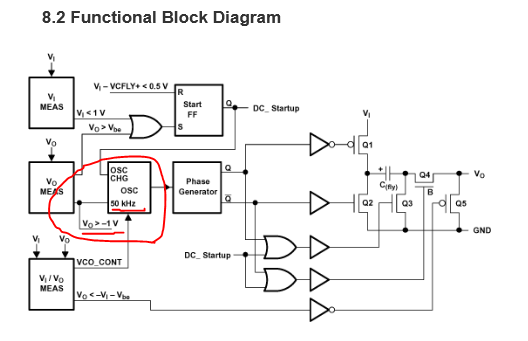

The datasheet doesn't descript about short protection.
