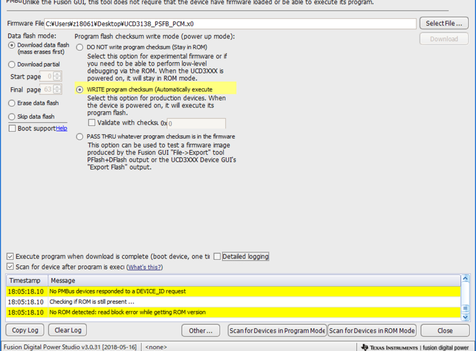

Part Number: UCD3138
After I do "WRITE program checksum" , This message was desplayed.
What does this message mean? What kind of causes can you think of?
Have you modified the program? Or the downloaded program is the original TI code?
The message says that the GUI for some reason can not read the DEVICE_ID. DEVICE_ID is a string that can be read by the GUI to know what kind of application firmware is downloaded.
Please click on the DEVICE_ID on the main screen from the device GUI again and see if it responds when asked again after the above mentioned failure in reading the DEVICE_ID
