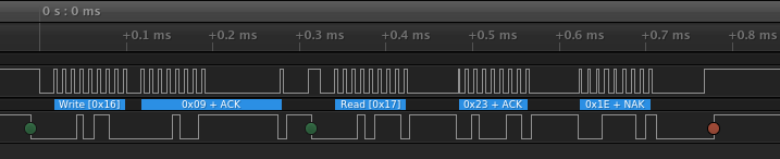

I noticed some odd behavior when trying to read data from the fuel gauge.

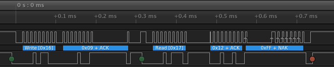

Following the SMBus specification, a read word operation has no stop between the write and the read i2c operations. If I use this protocol, the fuel gauge returns bad data often. Sometimes the data makes sense but other times it is garbage.
  NO STOP - READ WORD - PASS
  NO STOP - READ WORD - FAIL (Bad data)
However, if I break the protocol and insert a stop between the write and the read operation, then the fuel gauge consistently returns the correct value.
  WITH STOP - READ WORD - PASS

  • Hi Akash,
    From the logic analyzer captures, the only anomaly I see in the failed transaction is that there is an extra clock pulse on the failed read.
    However, I also see some other differences when I use bqStudio and look at the signals (apart from the PEC).
    I see a distinct ACK compared to what you are seeing.
    The extra clock pulse can definitely cause an issue in reading out the correct value.
    To debug the issue, I would recommend looking at the same transaction using bqStudio, vs your standard host. I would ignore the PEC part of the transaction using bqStudio.

  • That is a really good catch, Swami! I totally missed the extra clock. I don't know what is causing it but I'll take a look at this on the scope to make sure that it isn't an artifact of the logic analyzer. Although, the coincidence is too much to believe that this comes from the logic analyzer.
    Thanks for your help! I will close this for now and if I can't get the problem fixed on my side, then reach out on the forum again.
  • Just to tie up all loose ends. It turned out that the problem was with the microcontroller that we were using. The i2c block puts out a tiny clock (~0.6us) after a clock stretch which is really problematic with a 100 kHz clock (Basically, the i2c block did not handle clock stretching correctly). The fuel gauge doesn't see that first clock so everything is offset by 1 clock on the fuel gauge causing the problem that was seen.
