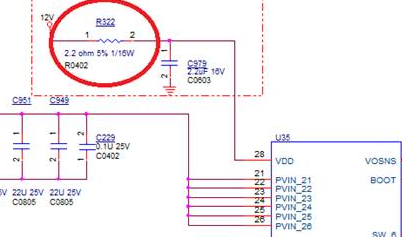

Hi E2E,
We use TPS549D22 to design. Because I put a resistor for RC filter at input side. please refer the circuit as below.
How much IVDD did IC need? I have to calculate the PD to choose suitable resistor's(R322) size.
VIN=12V, VOUT=0.8V, IOUT=40A, SW=650kHz
