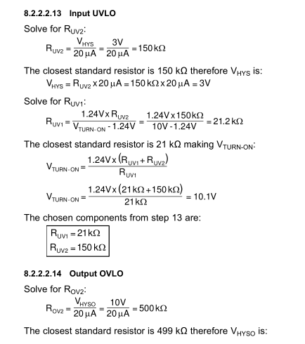

    after gone through the sections then only the doubt raises .I am attaching the image please see,
    first you took Vhys=3V right? then you calculated Ruv2 , then again you took Ruv2 to show Vhys=3V. why?
    the question is why you choose Vhys=3V here, what is the base of this assumption?
    same case is with Rov2 or you can say OUTPUT OVLO. Vhyso=10V HOW? or WHY?

  • Hi Vaibhav,
    This is a standard way for us in term of recalculating the Vhys.  Since there are instances where the calculated value is not a standard resistor value and that's all.  You can choose Vhyst with different value if you like but understand that when you first start, the current will be drawn and the input voltage can droop due to power line impedance losses and that's why we chose 3V.  For instant if you choose 2.9V then Ruv2 = 2.9V/20uA = 145K but there is no 145K and the closest 1% standard value is 143K or 147K then you use the value that you select to recalculate your actual Ruv2.  If you choose 143K then the actual Vhys = 143K x 20uA = 2.86V.
    Again, you can choose whatever you wish for Vhys for undervoltage and over-voltage you wish but understand that input votlage will droop as you draw current especially for high power system.  As far as the over voltage is concern, it's a current source that drive LED's and if there are different loads thenthen the LED voltage can be different and or if you have an open circuit then the controller will turn off until the hysteresis is reached to protect itself.
