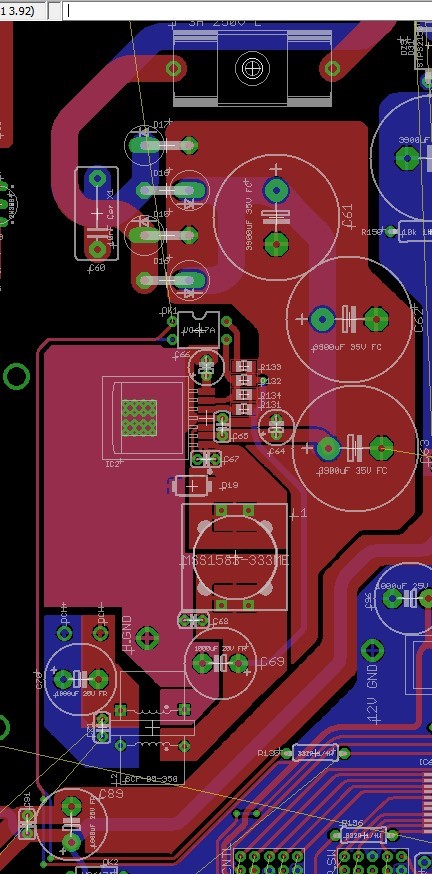

  • Hi Sam,
    Thank you for the quick reply! Please see attached. As of right now, there are a few value changes from the schematic:
    1. R186, was 7,5k now 4.64k (attempting to eliminate current limit)
    2. C126 was 1000uF, now 100uF
    3. L5, C124 removed.
    LM2679Schemo.pdf

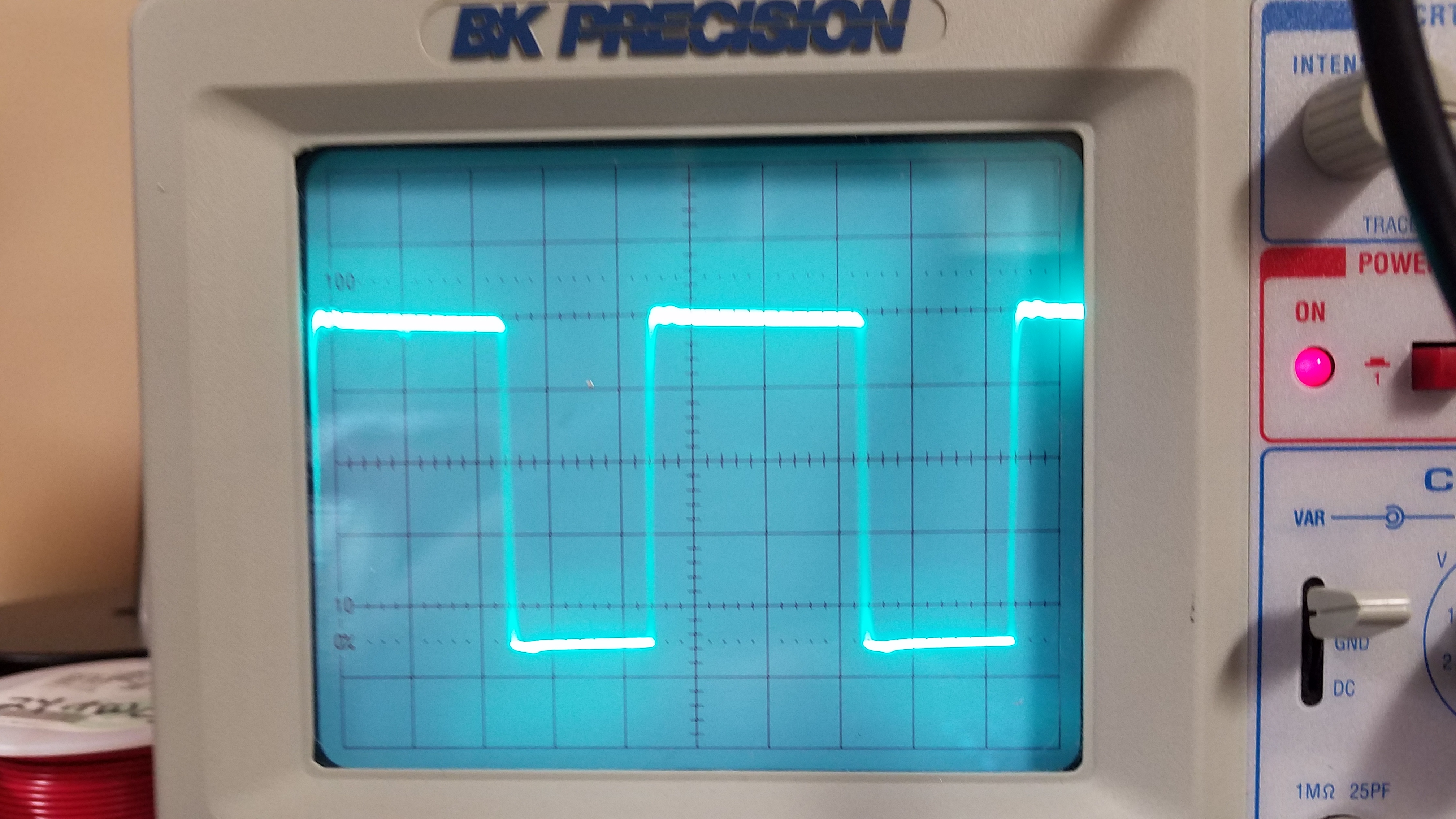

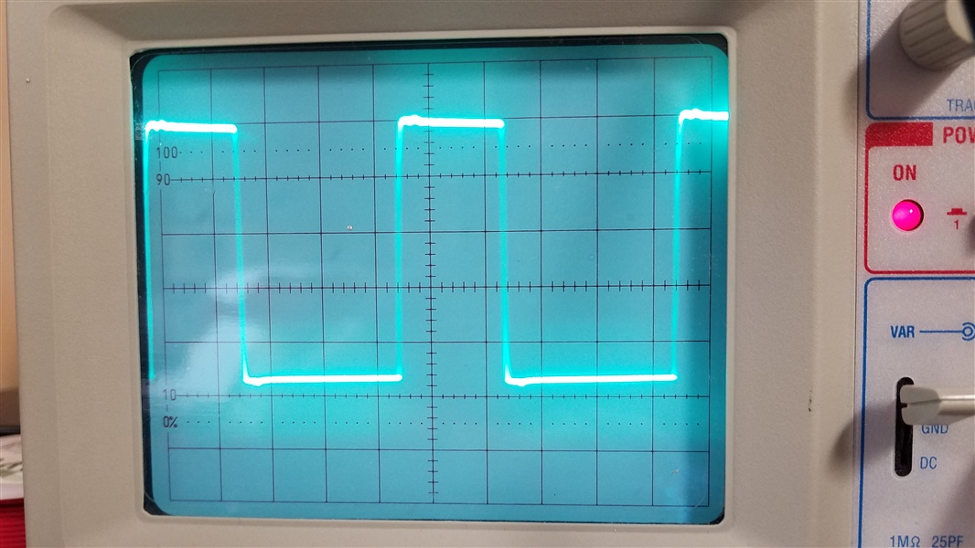

  • Ok, I've got some new info. First, attached are some scope shots.
    8V Output Diode Node12.2V Out Diode Node
    These are all 5V/d and .5us/d with a 1x probe with a diy ground spring that I made today with a load current of 1.8A. The 1st pic is in 8V mode, the second in 12.2V mode. What is interesting is that before I made the ground spring, we were getting the same old slow rising output voltage... but with the spring, the voltages reach their nominal values almost instantly. Funny enough, if I remove the scope probe after the voltage has risen to 8V in standby mode and set the unit to a 12.2V output, the voltage will actually fall from 8.1V to about 7.5 and will never rise to 12.2V. The second I put the scope across the diode, the voltage instantly rises to 12.2V.

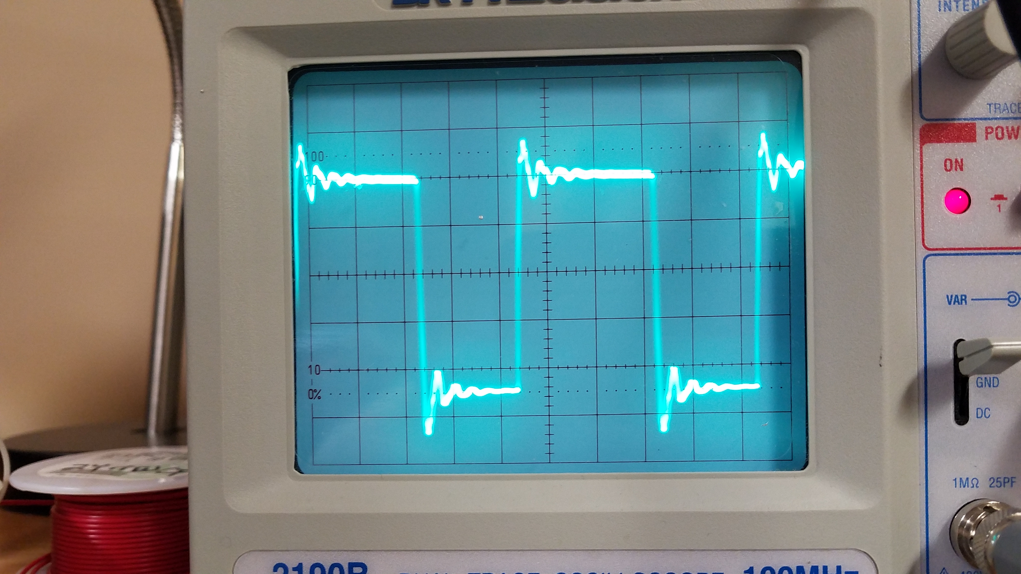

    12.2V Out Diode Node with Ringing
    Now, the third picture is in 12.2V mode but I'm not making great contact with scope probe. I believe this shows us more of what is going on when there's no scope. I notice that when I can make the ringing appear like this the output voltage drops to 11.6V. If the scope shows a clean square wave like the first two pics, then the output voltage immediately jumps to 12.2V again.
    My guess is the spring/probe are adding just enough capacitance to snub any instability in the IC output. Is there anything else that it could be? And if so, what do I need to do in the redesign to ensure I tame this ringing/instability in the first place?

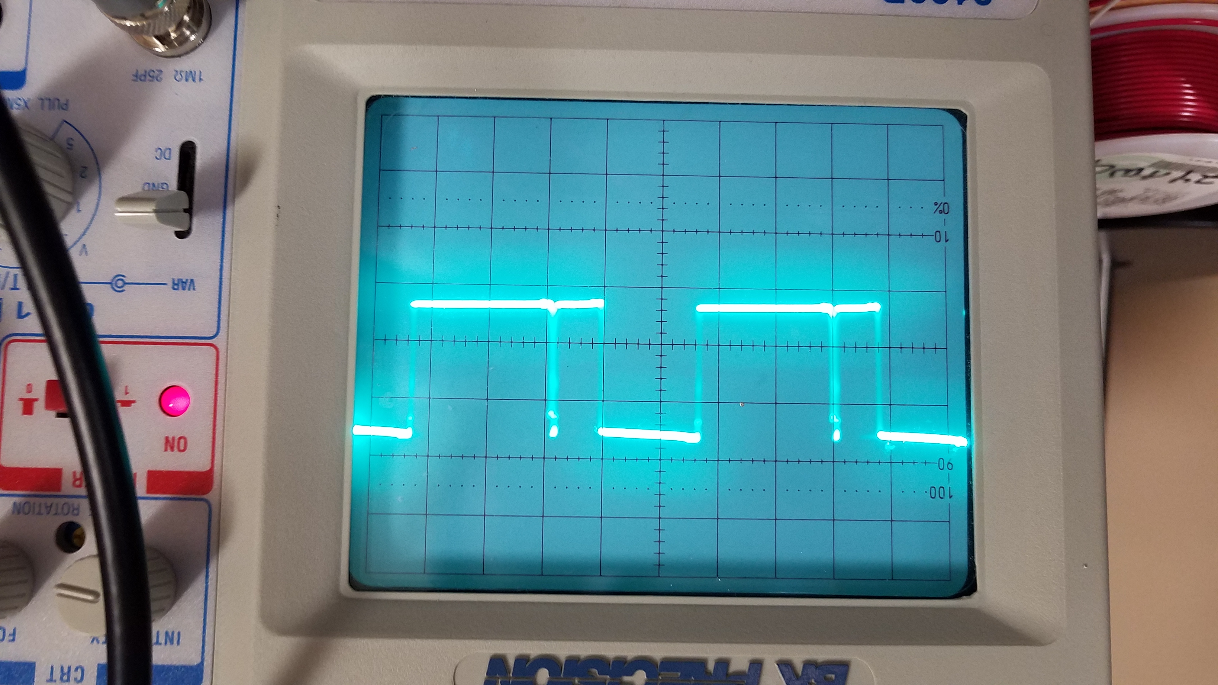

  • Ok, I think I've captured it finally by using the 10x probe setting and a different spring: a cycle is missing. See below.
    8V Low Voltage Diode Node
    I took this pic while the voltage was doing it's slow ramp up thing (~5V). Last night I was able to get the circuit working as expected (and at full current) if I touched a small film cap across the diode...100pF to 330pF all worked. If I touched the film cap across the diode while observing the scope, we would see another positive cycle where the spike appears in the image above, and instantly the voltage jumps to the correct value. When the cap is removed, we again see the above image and the output voltage drops.
    Interestingly the cap must be directly across the diode for the circuit to work properly. From the diode node to ground pin and input ground didn't work (as shown in the EVAL kits).
    What's going on here? Based on the scope, it appears to happen when the diode stops conducting, as if the controller is getting messed up and misses the next switch turn on. Ground bounce?
    Or, I'm beginning to suspect the diode (V8PA10) itself might be playing a role as it has a very high capacitance (850pF) and high reverse current, and they do not list the recovery time (which I assume means it is rather poor). Can the diode be playing a role here or is what we are seeing something else?

    In order to further test your idea about the input ground, you could try to scratch the ground plane of the input and flip the output capacitors to reference this same ground polygon.
