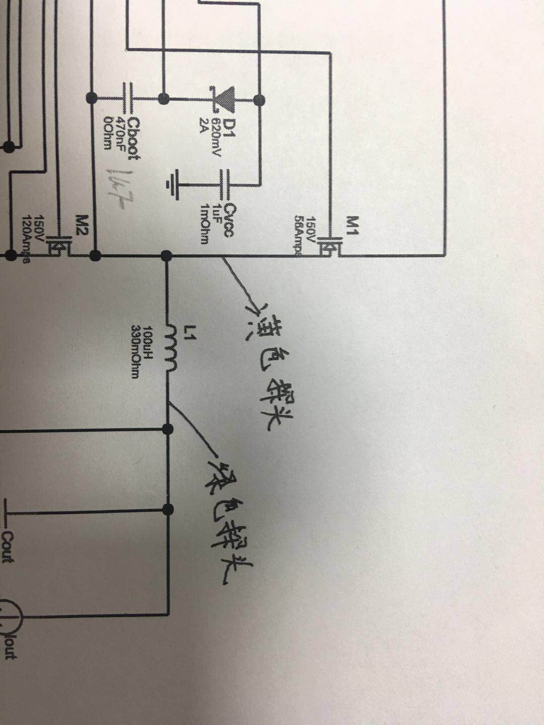

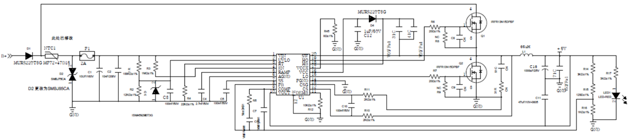

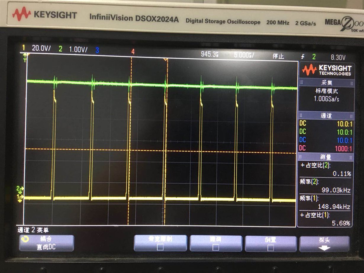

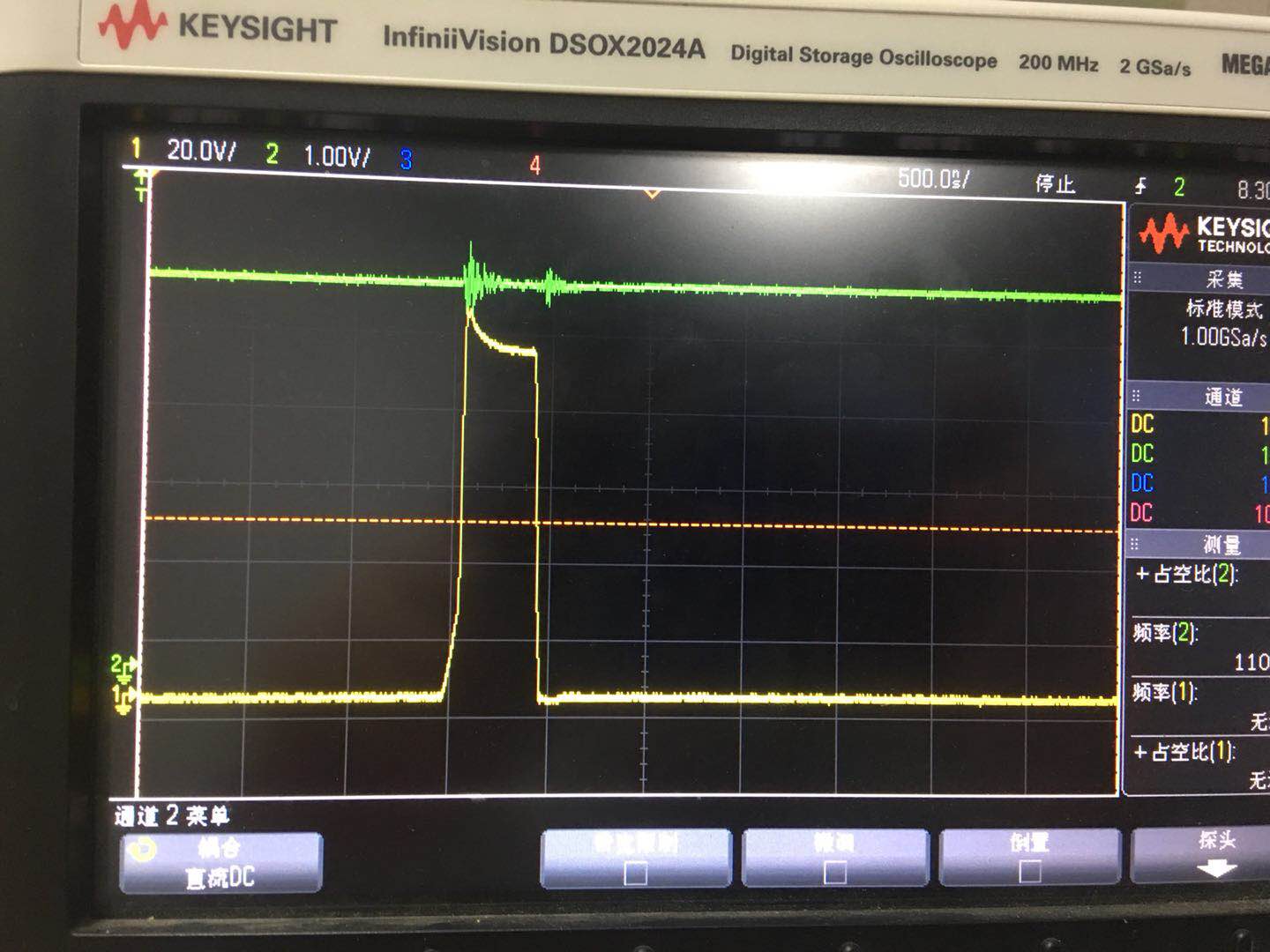

I use the LM5116 in our DC/DC design, the input voltage is 9-92V, output voltage is 5V, output current is 0.2A, inductance is 65uH, the switching frequency is 150KHz, we check the voltage of inductance with
your comment for this issue.

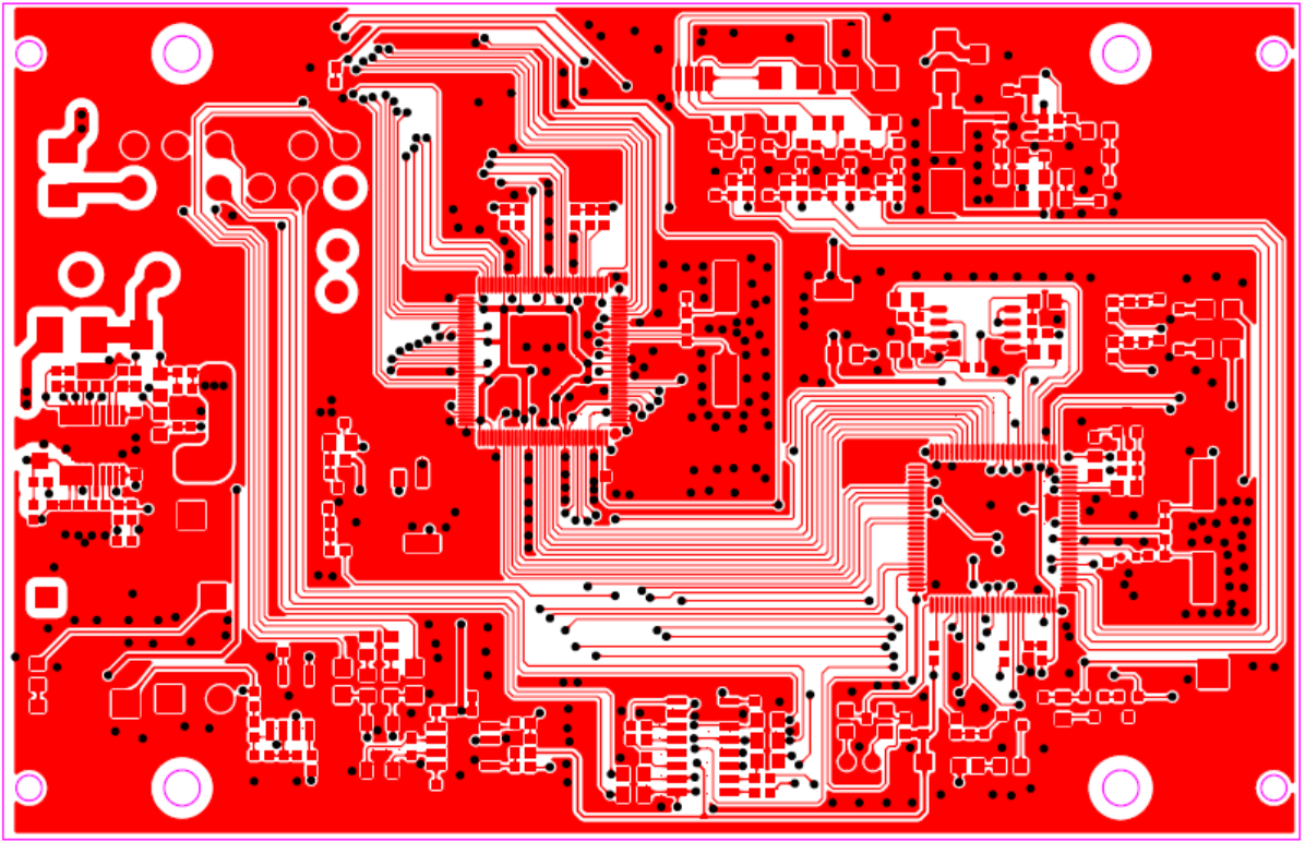

User,
Please share the full schematic and the full layout.
Are you using the tip and barrel method to measure VOUT? Sometimes the measurement technique shows noise that isn't really there so it's important to use the tip and barrel method.
-Sam
