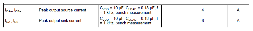

1. Source & Sink Current(Ioa+/Iob+, Ioa-/Iob-) are defined on the
    datasheet as typical. To calculate the gate charging/discharging time
    min/max would be significant, I think.
    Is it possible to clarify min/max source & sink current?
2. What is the main factor to create above variation?
    Accuracy of the internal current source?

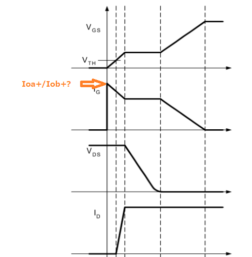

3. I wonder Source & Sink Current(Ioa+/Iob+, Ioa-/Iob-) will keep
    to complete the charging/discharging for Qg of external FET?

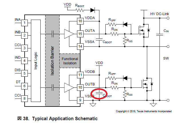

4. If Gate & Source was shorted on lowside FET(Source = GND),
    Is there any damage on UCC21222-Q1?

    1&2) The specified 4A/6A drive current capability of this and any other gate driver in general is taking during a very specific time of the source/sink transient currents at the specific conditions in the datasheet. Drive current will vary and is influenced by many factors including bias cap, PCB layout, external gate resistance, etc... I discuss a bit more on this separate thread below:
    e2e.ti.com/.../2885286
    Additionally, the tech below from my colleague discusses how to calculate and determine Ioh and Iol.
    www.ti.com/.../slla387.pdf

  • Dear, Mamadou-san.
    Thank you so much for your valuable information. I would like to make sure several.
    Please give your advice.
    1&2)
    I understand the source/sink current is influenced by many factor.
    However, RNMOS/ROL on internal transistor will be one of major factor.
    I wonder typ. 4A/6A specification are reflected on the worst case RNMOS/ROL
    (Highest & lowest)?
    If not, Is it possible to clarify min. or max as the reference? because min. will be
    important to estimate power dissipation, etc.

    I wonder Ioa+/Iob+ mean the peak as below?
    4)
    I understand the stored energy on CBOOT will be limited during gate-source short in high-side case.
    I wonder the situation in low-side case is same as high-side case?
    There is the possibility that gate-source short would be happened during manufacturing process
    such as miss-soldering, etc. So the customer is asking such.

  • Hi Sakai-san,
    1&2) The outputs are designed such that the internal pull-up and pull-down FETs will saturate around 4A and 6A respectively. The peak current will vary slightly with process, temperature, and voltage, but does not change significantly. The typical Rdson values do not change significantly and should be adequate for power dissipation calculations.
    3) Yes, Ioa+ and Iob+ peak during the initial switch from low to high, and slowly fall as Vgs rises, and Vds falls. These currents go to ~0A when the gate is fully charged.
    4) You are correct that if the gate was shorted to the source, the high side Cboot would quickly drop below the UVLO threshold and the output would turn off. The low-side, however, typically is directly powered from some kind of regulator. This output is more vulnerable to damage if the gate is shorted to the source and the regulator is capable of maintaining the VDD voltage at a higher input current. It is important to ensure that this short does not happen.

  • Dear, John-san.
    Thank you so much for your valuable advice.
    4A/6A typical source/sink current capability is defined on the datasheet.
    1. The minimum capability will be important for the customer.
        Is it possible to assure the minimum value?
    2. If can't assure,
       Is it possible to show the minimum value which your obtained at qualification
       test for UCC21222-Q1? It will be good reference for the customer.
    H. Sakai
  • Hi Sakai-san,
    1. I'm not sure if we can assure the minimum value. I've reached out to our internal team to see what data we have.
    2. I'll need some more time to look through our data. I'll update you once I find out more information.
    Can you explain more on why this number is more important? Is there a particular ambient temperature that's of most concern here?
    John
  • Hi Sakai-san,
    Our min peak source/sink currents are as follows:
    2-A minimum peak source
    3-A minimum peak sink
    Please let me know if you have any other questions. If not, could you please press the green button?
    John
